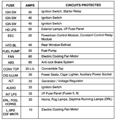

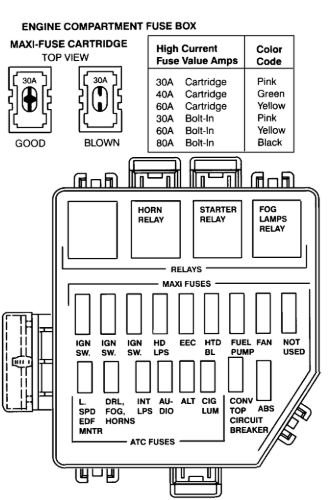

Two more things to check. First, conform the fuses indicated in pic 1 are good, fuel and EEC. Also, I need you to locate the fuel inertia shut off switch in the left side of the trunk. This device is used to shut off fuel in the event of an accident. I didn't mention it because you said the engine was running until it was turned off. However, try resetting it to see if that makes a difference.

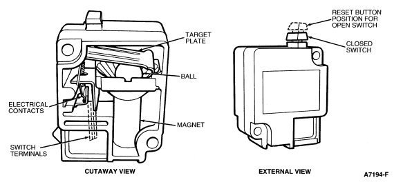

Here is the manufacturer's definition of the inertia switch. Also, picture 3 shows the switch and where the reset it located.
Inertia Fuel Shutoff (IFS) Switch
The inertia fuel shutoff (IFS) switch is used in conjunction with the electric fuel pump. The purpose of the IFS switch is to shut off the fuel pump if a collision occurs. It consists of a steel ball held in place by a magnet. When a sharp impact occurs, the ball breaks loose from the magnet, rolls up a conical ramp and strikes a target plate which opens the electrical contacts of the switch and shuts off the electric fuel pump.Once the switch is open ,it must be manually reset before restarting the vehicle. Refer to the Owner Guide for the location of the IFS.
