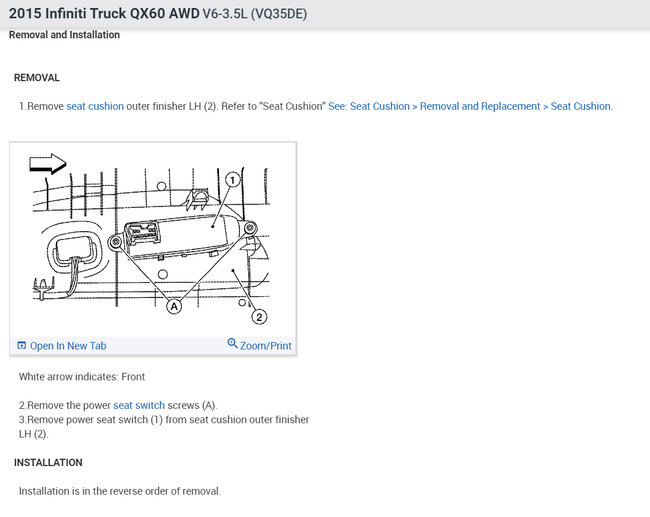

Please show how to replace the front passenger seat switch on the vehicle listed above. Thanks

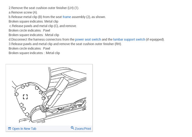

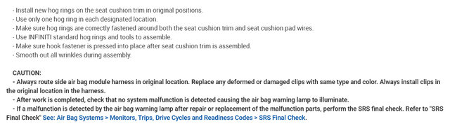

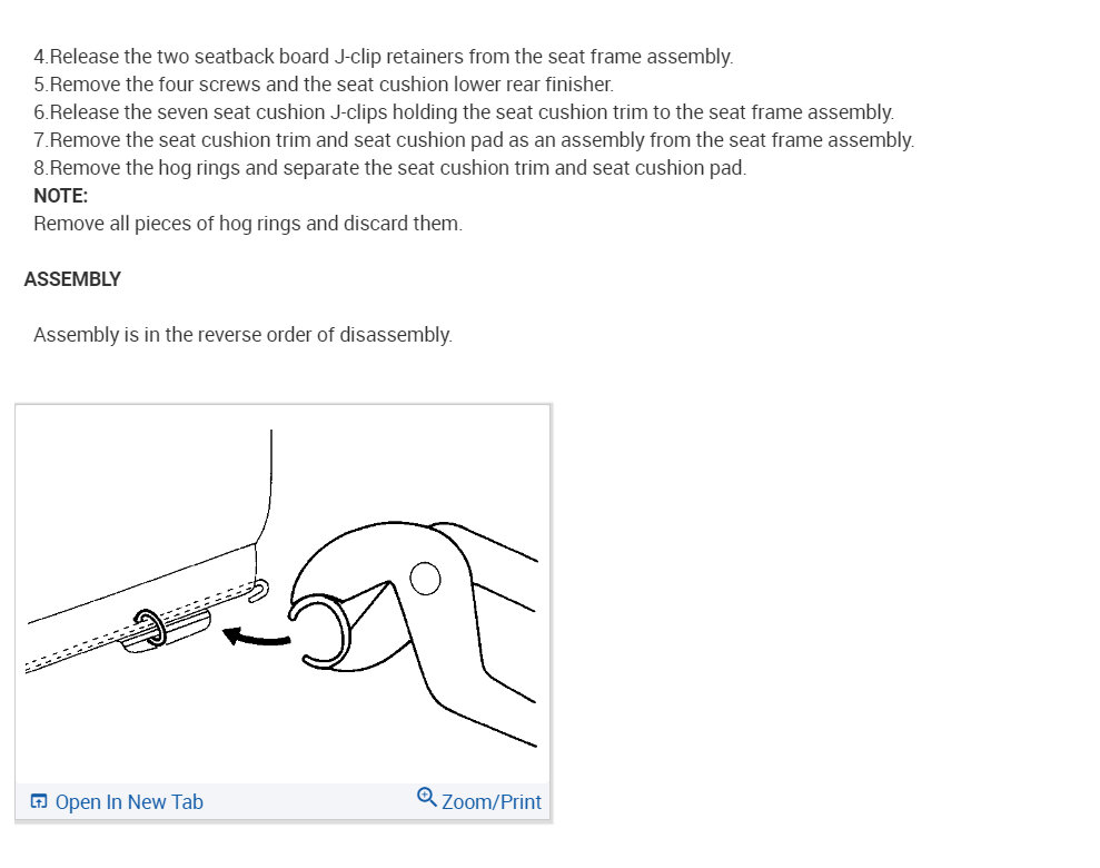

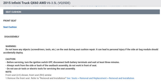

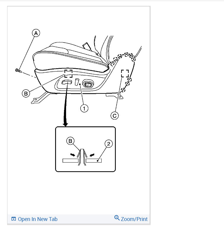

It looks like the seat cushion needs to be removed to replace the control switch. Here are the instructions on how to do the job in the images below. Check out the images (below). Let us know what happens and please upload pictures or videos of the problem so we can see what's going on.
