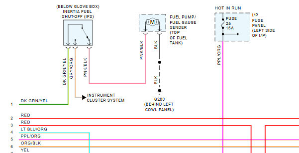

I need the wiring color/diagram for the fuel pump.

Sure, here you go, just two wires, check out the images (below). Let us know if you need anything else.
Image (Click to enlarge)
