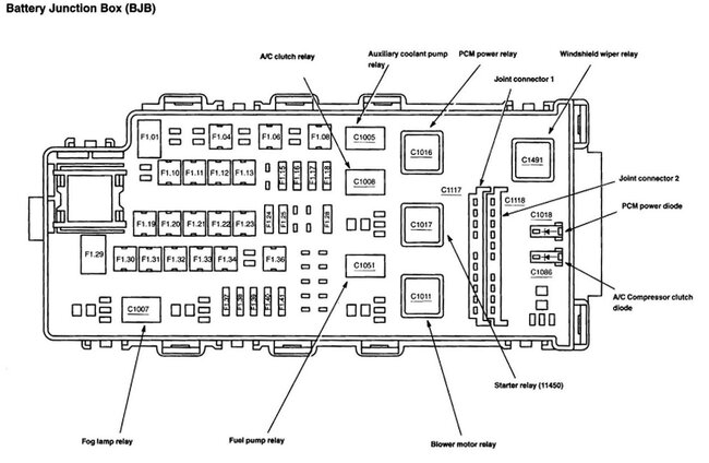

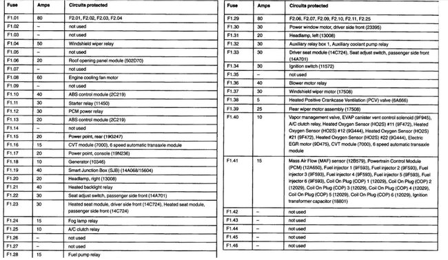

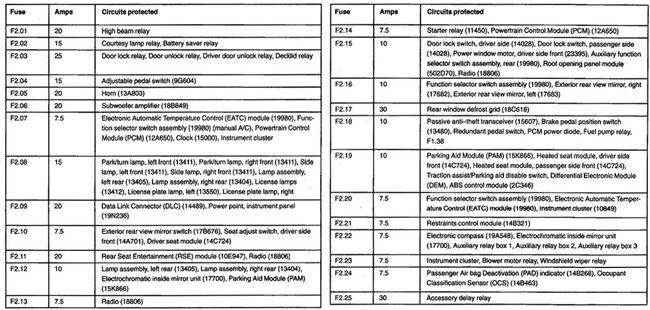

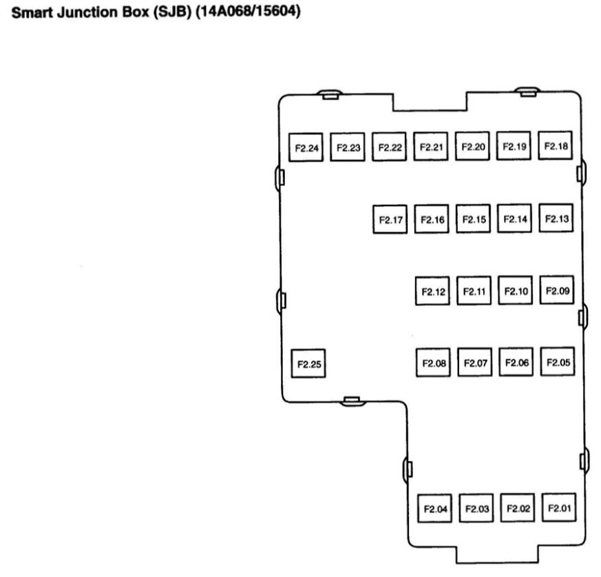

It could be the compressor has gone bad, does the compressor clutch kick on when the system is on? Here is a video and a guide to help us fix the problem and I have included the fuse diagrams as well, in the images below.
https://youtu.be/4EqdrBVb0sY?si=XsQkEQQ0uTl28Hv7
and
https://www.2carpros.com/articles/car-air-conditioner-not-working-or-is-weak
Here are the fuses locations as requested. Check out the images (below). Let us know how it goes.

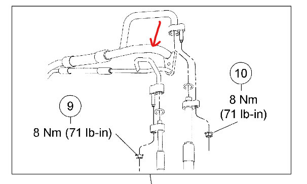

Okay, if the clutch engages, please feel the low side tube coming out of the firewall to see if it is cold. If so, you may have a temperature blend door actuator that is not working, and if it is not cold, we will need a high side pressure reading to determine if the compressor is bad. Check out the images (below). Please let us know what happens.
