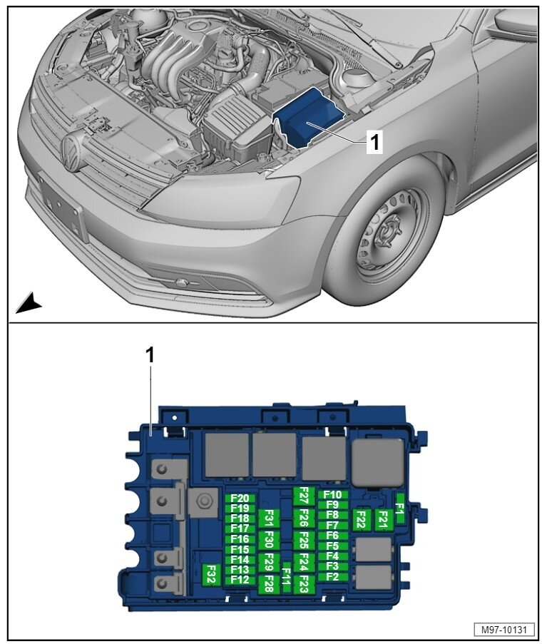

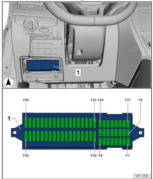

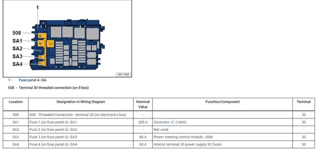

Some fuses are missing in the fuse box. I could not find diagram in owner's manual. looking for diagram for under the hood and under the dashboard.

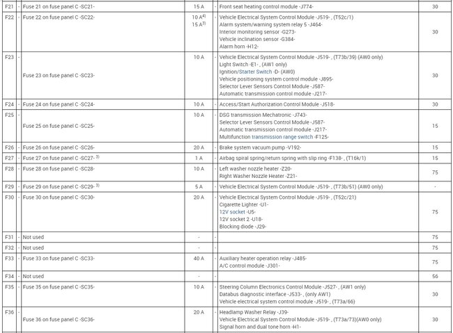

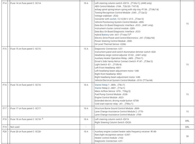

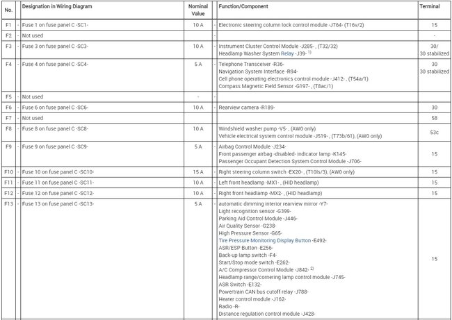

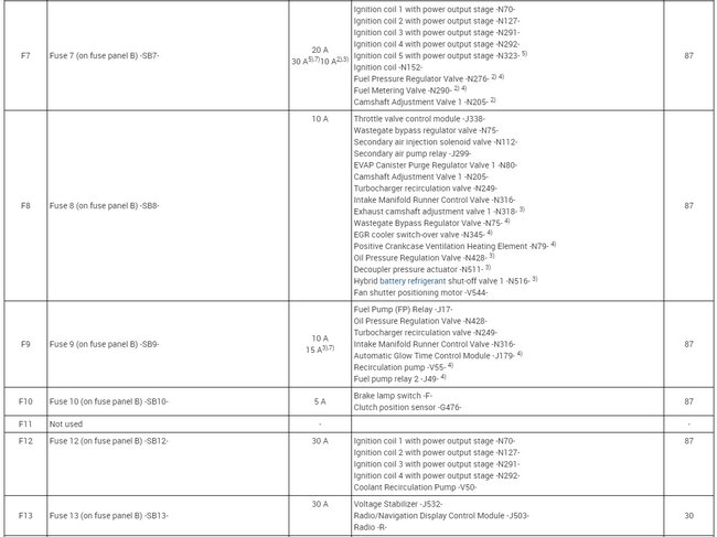

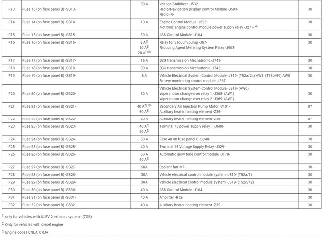

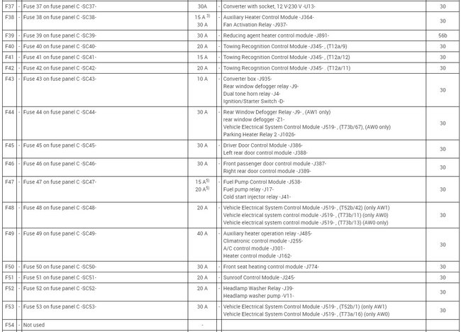

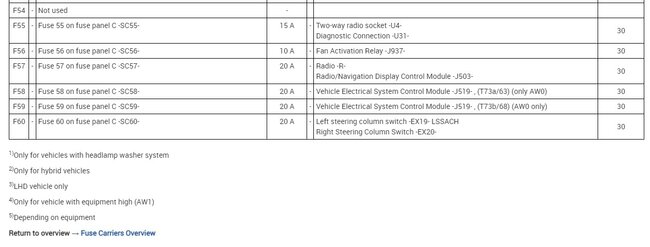

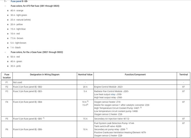

These images are the fuses used in that car. Be advised it's normal for there to be empty fuse slots as they use a common fuse block but not all the option fuses get installed. Are you having an issue?
