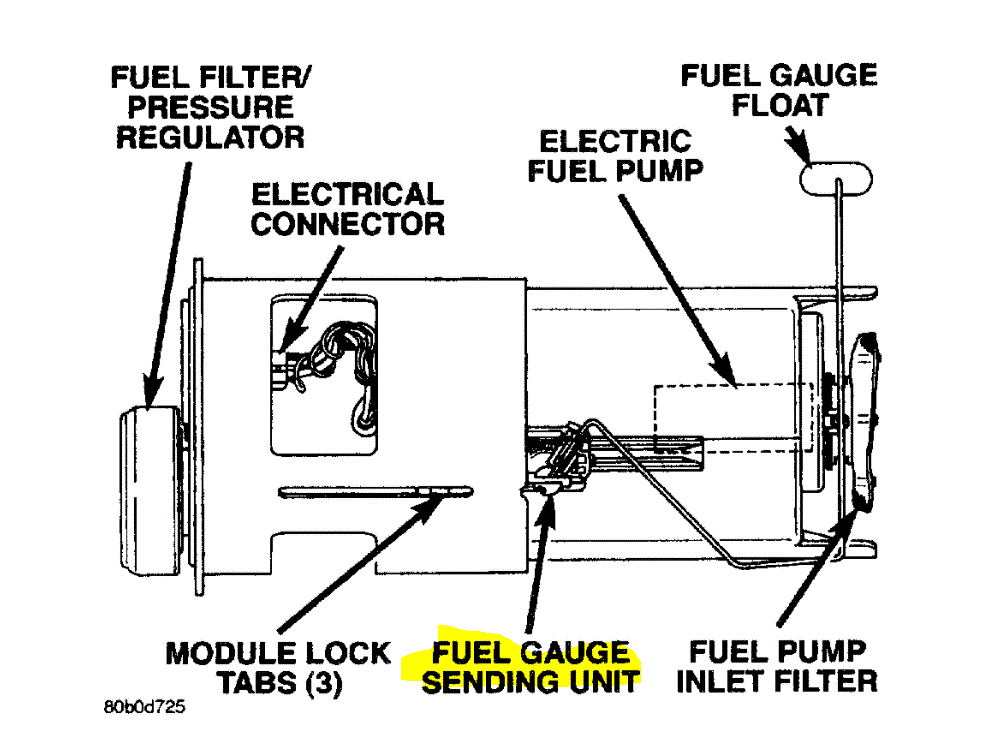

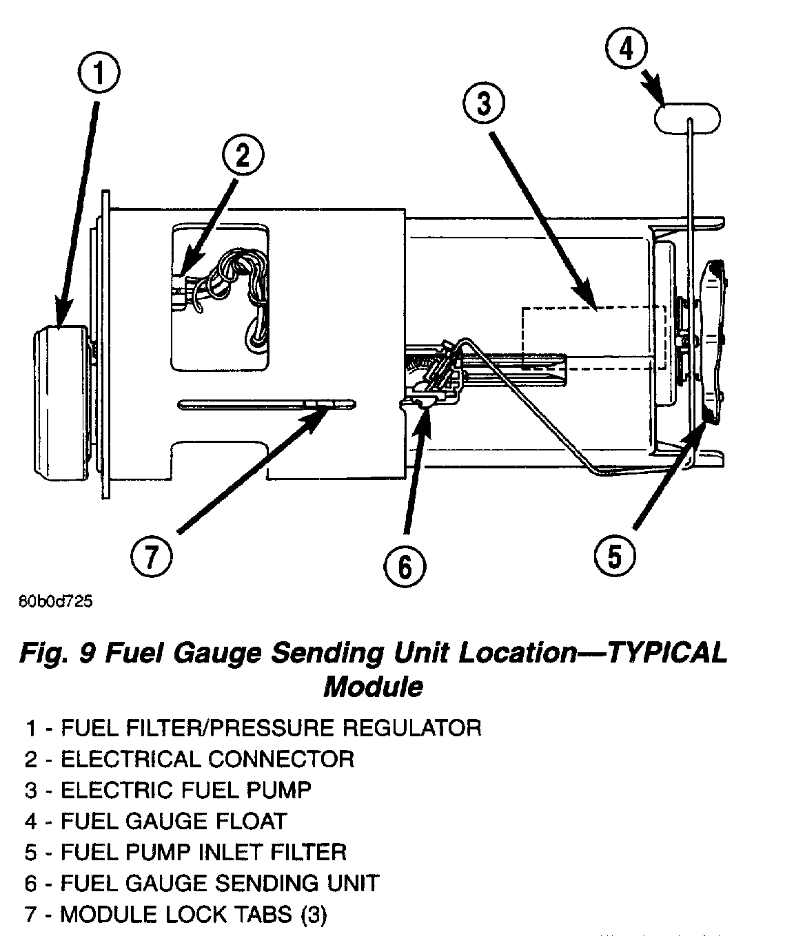

Now, if you find there is no resistance or no resistance, you will need to replace it. It is located on the fuel pump module in the tank. Pic 1 shows the location of the sensor (rheostat).
Here are the directions for repairing it, but in all honesty, you are better off jus getting a new pump because it should come with a new sender

Fig. 9 Fuel Gauge Sending Unit Location - Typical Module
pic 2
The fuel gauge sending unit (fuel level sensor) and float assembly is located on the side of fuel pump module (Fig. 9). The fuel pump module is located inside of fuel tank.
1. Remove fuel tank.
2. Remove fuel pump module. Refer to Fuel Pump Module Removal/Installation.
3. Unplug 4-way electrical connector (Fig. 9).
4. Disconnect 2 sending unit wires at 4-way connector. The locking collar of connector must be removed before wires can be released from connector. Note location of wires within 4-way connector.

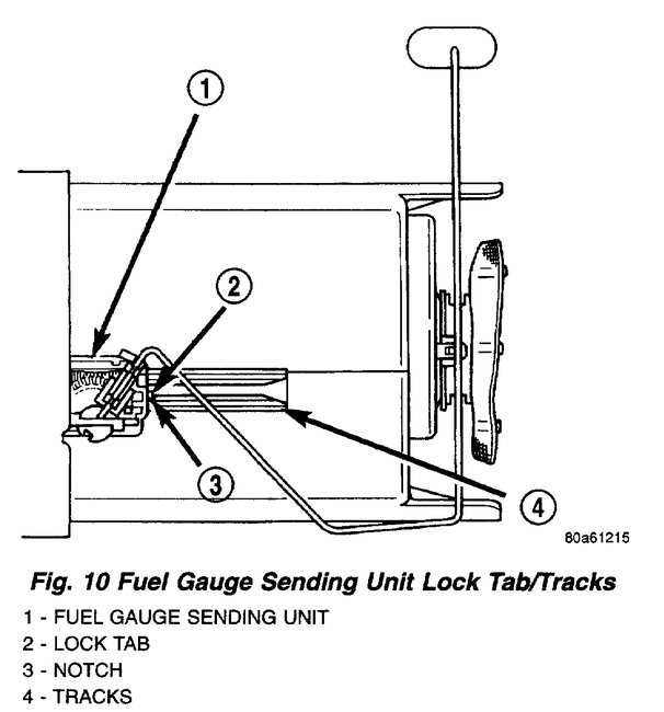

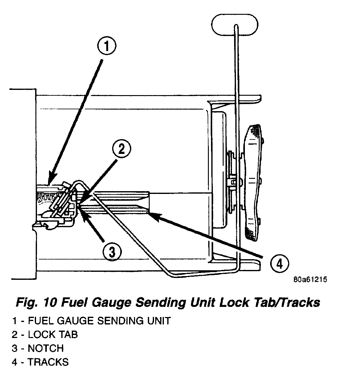

Fig. 10 Fuel Gauge Sending Unit Lock Tab/Tracks
pic 3
5. The sending unit is retained to pump module with a small lock tab and notch (Fig. 10). Carefully push lock tab to the side and away from notch while sliding sending unit downward on tracks for removal. Note wire routing while removing unit from module.

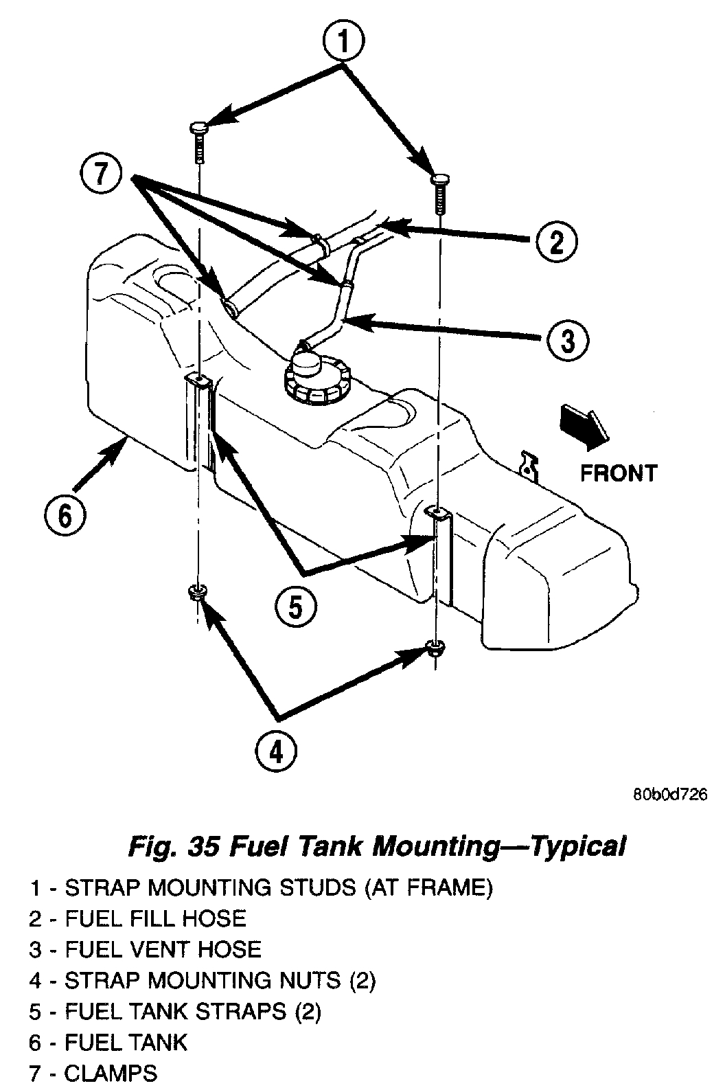

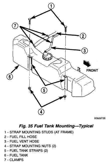

Fig. 35 Fuel Tank Mounting - Typical
pic 4
8. Remove fuel tank mounting strap nuts from mounting strap studs (Fig. 35). If equipped, remove fuel tank shield bolts.

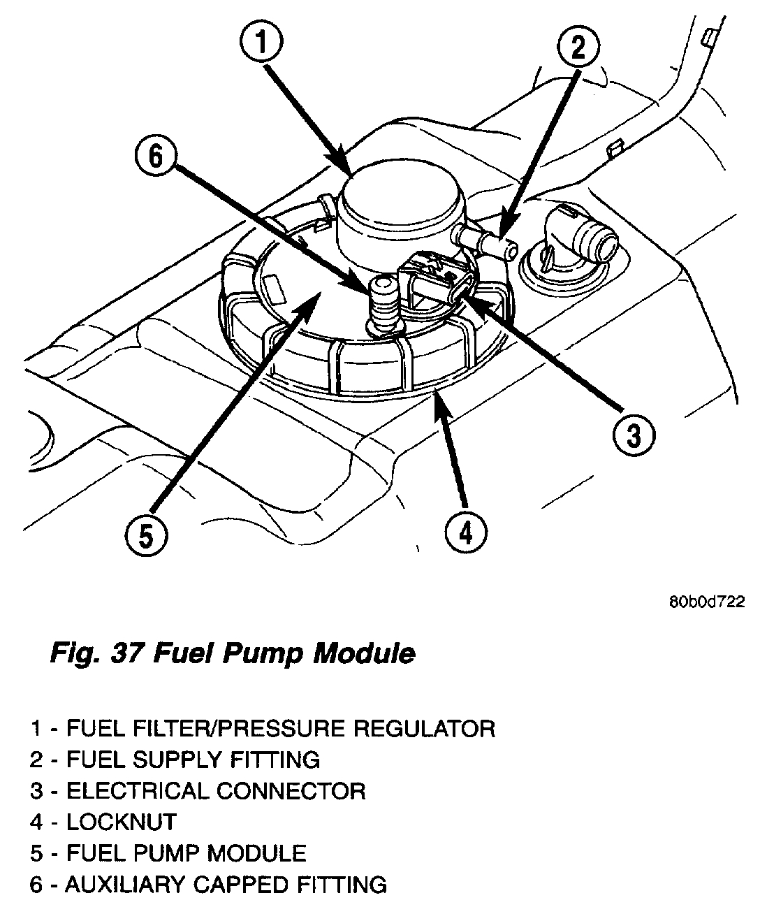

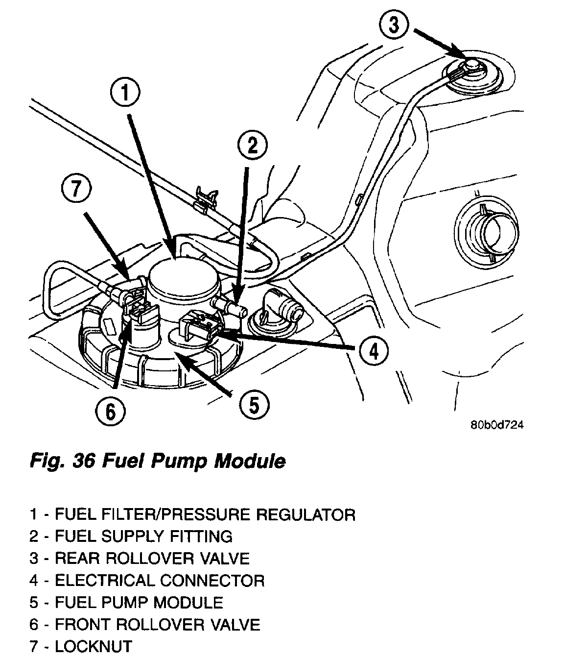

Fig. 36 Fuel Pump Module
pic 5

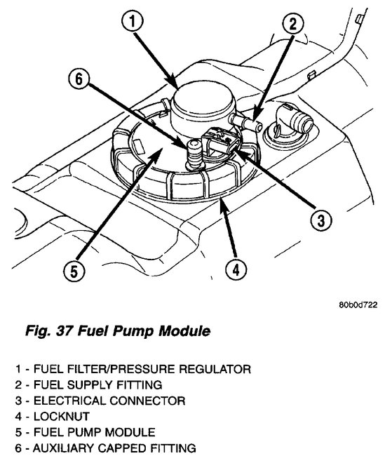

Fig. 37 Fuel Pump Module
pic 6
a. While working over left rear tire/wheel, disconnect wiring harness connector from electrical connector at top of fuel pump module (Fig. 36) or (Fig. 37).
b. If equipped with 26 or 34 gallon fuel tank, two EVAP lines are connected to rollover valves. Disconnect EVAP line from rollover valve at top of module (Fig. 36). Disconnect other EVAP line from rollover valve near rear of tank (Fig. 36).

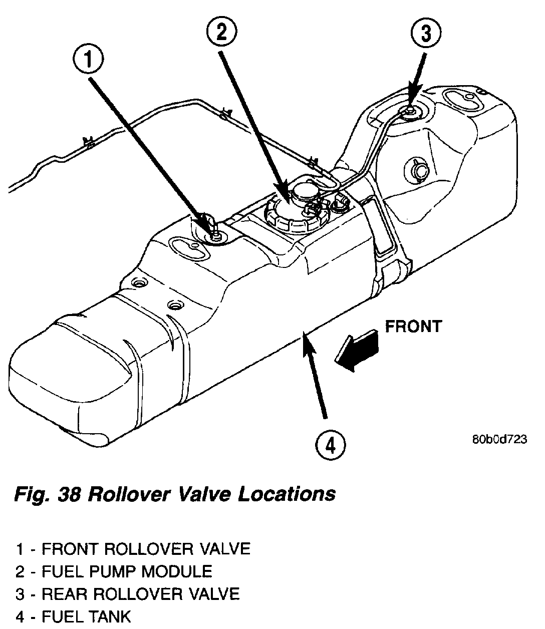

Fig. 38 Rollover Valve Locations
pic 7
c. If equipped with 35 gallon fuel tank, two EVAP lines are connected to rollover valves. Disconnect EVAP lines from rollover valves at top-front and top-rear of fuel tank (Fig. 38).
d. Disconnect fuel supply line at fuel filter/fuel pressure regulator supply fitting (Fig. 36) or (Fig. 37). Refer to Quick-Connect Fittings for procedures.
