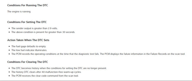

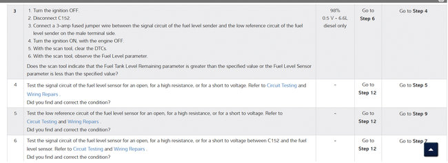

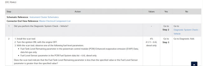

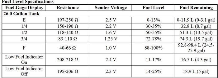

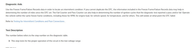

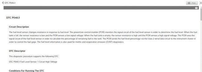

In the tank, there is a float that is attached to a rheostat. The rheostat sends a voltage signal to the PCM which goes to the BCM and then to the gauge. Ugh!! A lot of things there.
I suspect the rheostat is bad or the float is going bad, However, If you look through the attached pics, they indicate the diagnostics for troubleshooting the issue.
Let me know if they help or if you have other questions.

The info I looked at was for 5.3L vin B, single tank.. The gage will default to empty if, the pcm detects a problem with sending unit circuit or if the ipc detects a problem with class 2 data from pcm.
You may be able to check gage reaction with resisters, get about three, 250 ohm--empty, 140 ohm--1/2 tank, 66 ohm--full tank. If the gage reacts correctly to each resister, I think the problem is the sending unit in the gas tank. If it doesn't react correctly could be a problem with pcm--ipc or wiring circuit.
The wire colors for the sending unit are black--ground, dark blue-- voltage. If you use a resistor between those two wire colors, key on, no need to start it, the gage should react. The voltage is a 5 volt ref circuit from the pcm.
You can get resisters from radio shack, don't cost much. You can also check for applicable trouble codes. Some of the national brand autostores will check codes for free. I just don't know if they will check manufacturer specific codes?

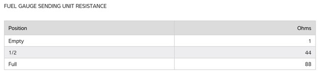

If the pump unit had the swing arm and float, then yes. You should be able to take the connector loose from pump assemble, use a resistor between proper two terminals, key on, see if gage reacts to resistor, try a couple resistors for full and low. The resistance spec is in the diagram. Radioshack sells resistors, don't cost much. If the gage reacts properly then the problem is either the sending unit or connector.

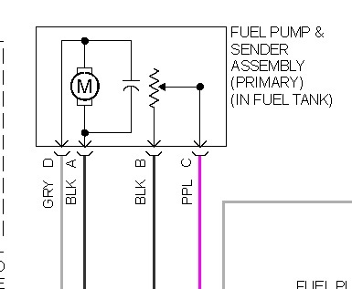

JDL
  • 16,098 POSTS
Wanted to show sending unit circuit. Except hybrid.
Purple wire and black wire is for sending unit.
Jun 2, 2021 at 12:35 PM (Merged)

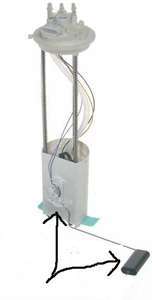

Chances are the float level gauge is going bad. The only problem, it is part of the fuel pump in the tank.

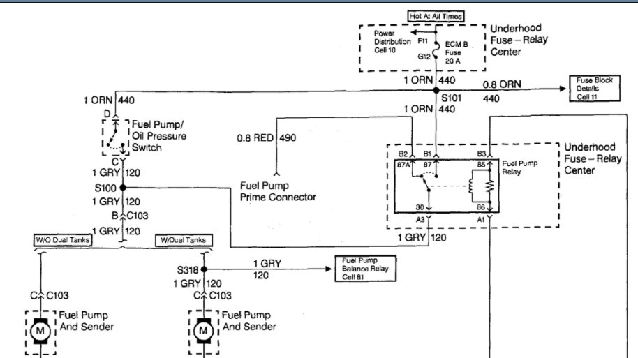

Hello, I'm Danny.

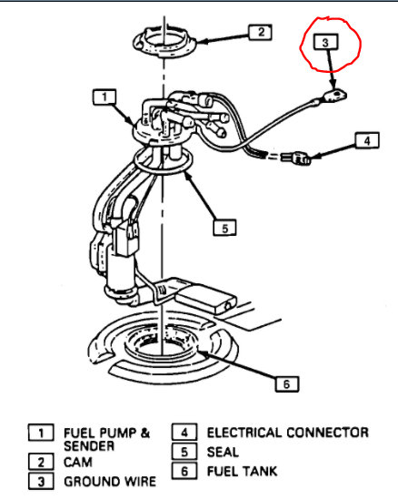

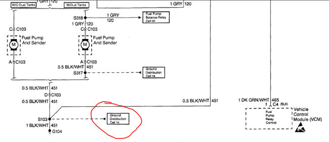

The 1988-1998 Chevrolet obs had a problem causing weird gas gauge related problems. You should first check the fuel pump- sender ground wire that attaches to the frame. There is also a ground strap that goes from the fuel tank to the frame. Sometimes road debris or road conditions can deteriorate are dislodge-destroy the ground strap and create havoc with the fuel gauge. Here is a wire testing tutorial for you as well:
I've attached a fuel pump wiring diagram below for your truck. The ground is cell 14 and I circled it in red. Let us know what you find after you clean, check and inspect the ground wire and ground strap. Hope this helps and thanks for using 2CarPros.

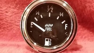

Hi I want to install a Fuel Level Gauge. My cluster fuel Level gauge does not work. How would I install a Fuel Level Gauge? Where would I run power from to make it work. This is what I am looking to install. Thanks.
Jun 2, 2021 at 12:36 PM (Merged)
SEAN SILBERHOLZ
  • 44 POSTS
This is what I am looking at.
HMAC300
  • 48,601 POSTS
first does the current gauge read full or empty. have you tested to see if sender is working. are there instructions with the new gauge you want to put in? one wire will need low voltage to operate it like 6-7 volts other to sending unit and other to ground if a 3 way connection. see pics how to check current problem.
SEAN SILBERHOLZ
  • 44 POSTS
Hi mine reads high past the f on the cluster after 100 miles it starts to move and then when I am at 1/2 a tank and I am sitting in traffic or at a light it goes down into the yellow and when I start driving again it goes up to half a tank their was one time it showed I had a half a tank and I only had 5 gallons in the tank. I had the fuel pump replaced. That fuel pump worked started driving it 7 months later I kept complaining it kept cutting off. The shop that put the new fuel pump in it said it was not the problem. So I took it to a friend and he recommended I buy a new throttle body. I was not convinced. So I bought it put it on and had the same problem. So I had bought a new fuel pump and fuel filter. He took the fuel filter off and said rust was coming out of the line. So he replace the filter and fuel pump. He said the tank was rusted but I needed too see what was going to happen. It kept doing the same thing it was stalling and dying. So I bought a new tank and got a new fuel filter and fuel pump. So I know it's not the sending unit. I also had bought a new fuel pump relay. I tested the cluster fuses and it had power. I also changed that fuse out and it made no difference. Thanks.
