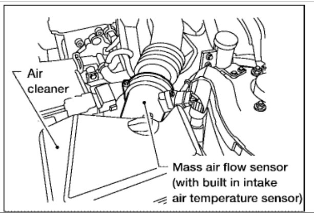

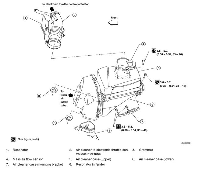

I have seen where the MAF sensor stops working right causing he engine to use more fuel.
Here is a guide to help you change the sensor out:
https://www.2carpros.com/articles/how-to-replace-a-mass-air-flow-sensor-maf
Check out the diagrams (below).

Never smell fuel, it rolls down an incline in neutral (easily). Drive is about ten miles plus, one way, freeway speed of sixty five to seventy mph and the rpm's are usually around 3,000. Manual says this model does not have a MAF sensor. But that it does have a more improved system that would have to be checked by a pro. I drive sensibly. May just have to take it for service I am trying to save money, as I am retired and do not have much of it! Car repairs and vet bills are a luxury. I did notice today that it does seem to be running a little rough. But it did pass its smog test not so long ago. Been using mid grade gas from the better stations almost all the time too.

The book may call it an air flow meter, but it is the same thing as a MAF sensor. It is bolted to the top of the air cleaner housing.
