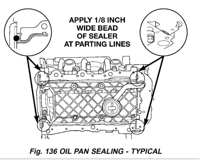

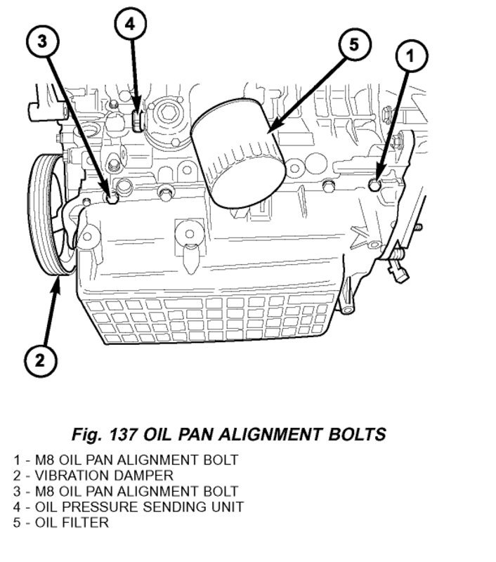

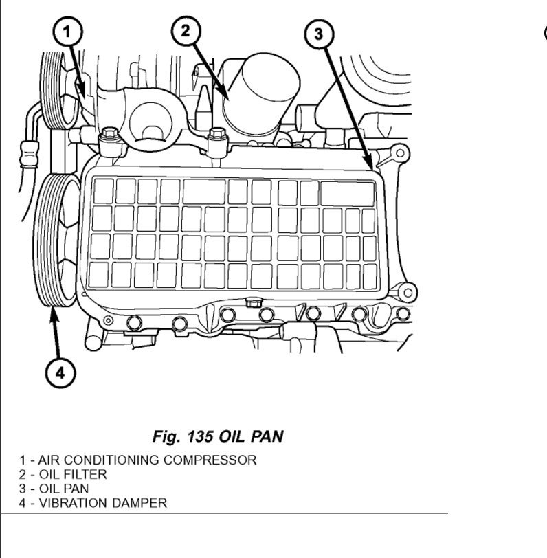

You will need to disconnect the battery and drain the oil before you begin. Also you will need to jack the car up.
Here are some diagram (below) of what to do to check the oil pan on your car.
