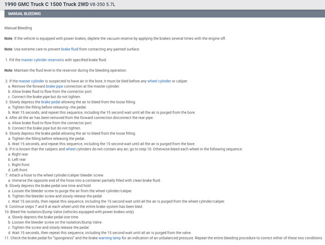

I have worked on a lot of brakes and never had this problem before, with engine off I have good pressure on pedal but after I start the truck the pedal goes to the floor and never regains good pressure. I have replaced the brake booster and bled the system, any help would be appreciated.
