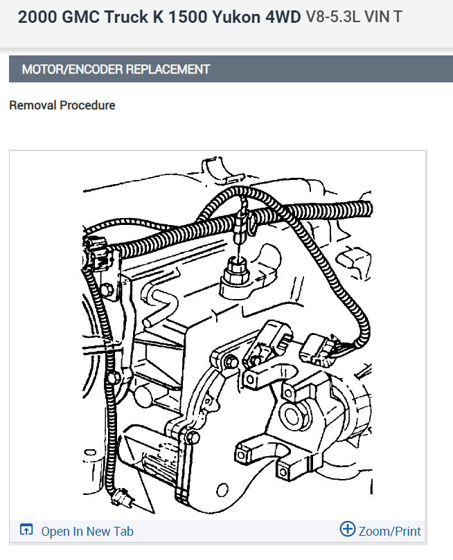

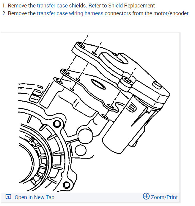

yep, I agree the transfer case shift actuator gets weak and it needs to be replaced. here is the location and how to change it out. Check out the images (below). Let us know how it goes
