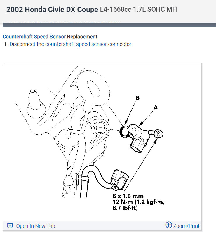

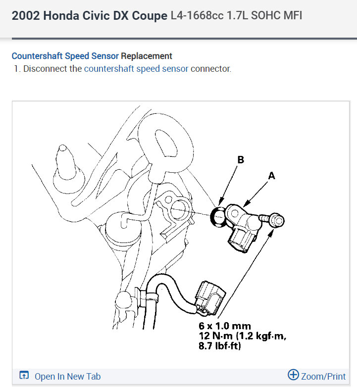

This is common when the countershaft sensor starts to go out but, we should check the fluid level and condition in case the transmission needs to be serviced. Also, is there a check engine light on? If so, please go over this guide to get the codes.

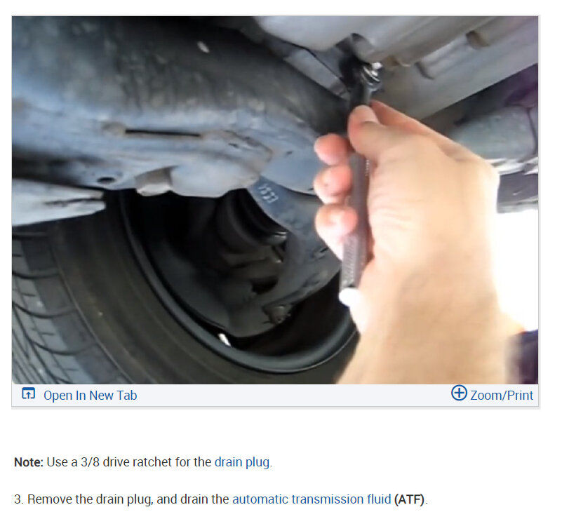

Here is a generic guide to help you step by step with instructions in the diagrams below to show you how on your car.

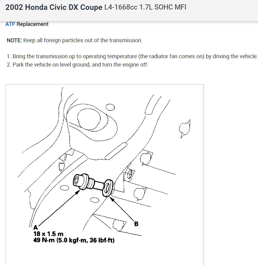

Note: Use a 3/8 drive ratchet for the drain plug.
3. Remove the drain plug and drain the automatic transmission fluid (ATF).
NOTE: If a cooler flusher is to be used, refer to ATF Cooler Flushing.
4. Reinstall the drain plug with a new sealing washer.
5. Refill transmission with the recommended fluid into dipstick hole to the upper mark on the dipstick. Always use Honda ATF DW-1 (ATF-Z1 has been replaced with ATF DW-1, Honda Service News Nov 2010) Automatic Transmission Fluid (ATF). Using a non-Honda ATF can affect shift quality.
Automatic Transmission Fluid Capacity:
2.7 L (2.9 US qt) at changing
6.0 L (6.3 US qt) at overhaul
Check out the images (below). Please upload pictures or videos in your response to the problem so we can see what's going on.

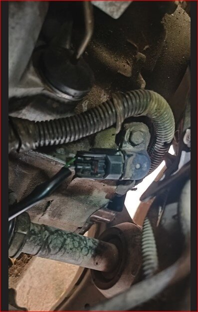

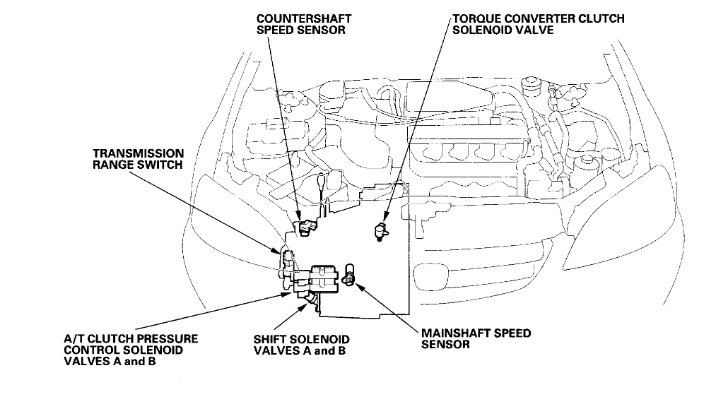

I noticed that the sensor near the dipstick is wet with oil up to the connector. (I think this is the countershaft sensor), problem still exist after cleaning it.

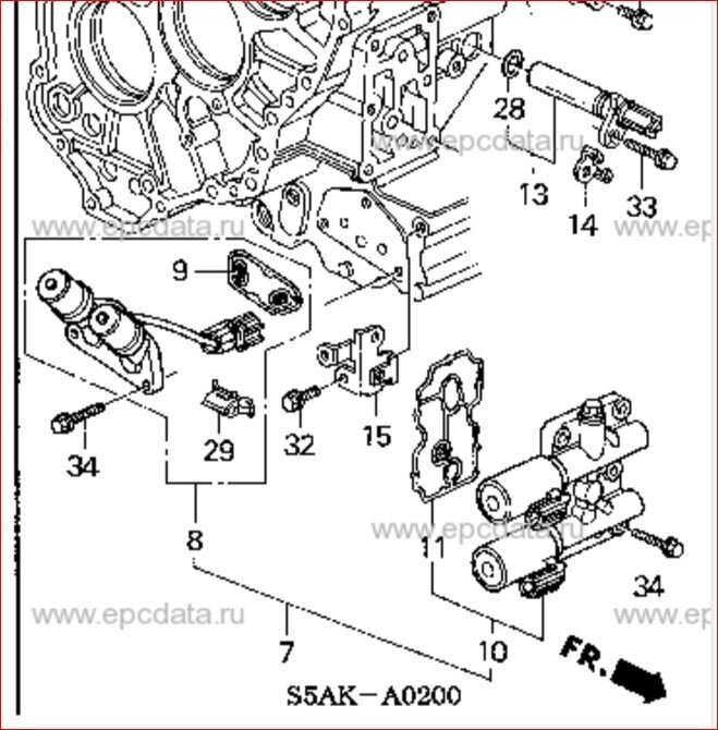

I also cleaned the linear shift sensor, number 10 in the diagram attached.

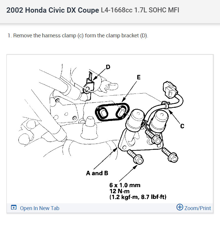

Can the shift solenoid be also the reason? Number 8 in the diagram. Also, can I pull it out just by removing the battery and other wires above it?
Mar 26, 2024 at 6:32 PM

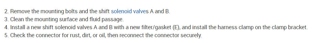

Usually there will be a trouble code for the shift solenoid, but I would test the shift solenoids with a voltmeter to see if one has much lower resistance than the other, they should be about the same.
Here is a guide to help:

I will try to do resistance test since there is no trouble code during scan. Maybe a little cleaning will help. Can i pull the shift solenoid by just lifting the hood and taking out the battery and the battery holder?
Mar 30, 2024 at 6:58 PM
I believe so, remove anything in the way of doing the job, if you are not sure upload an image so I can help walk you through the repair.

Did you replace the counter shaft speed sensor? This is a problem with these cars, are is the location.
May 20, 2024 at 12:33 PM
SIMARUN08
  • 30 POSTS
Not yet, just cleaned the shaft speed sensor since there is no check engine light on.
May 20, 2024 at 4:01 PM

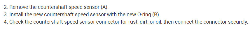

Yep, the sensor can still be bad, I would swap it out anyway. If the sensor becomes weak it will give false readings but not enough to trigger a check engine light.

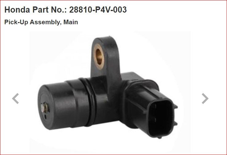

Would you mind sharing the part number of the shaft speed sensor?
Thanks
May 21, 2024 at 4:29 PM
SIMARUN08
  • 30 POSTS
Is this the sensor?
Thanks
May 21, 2024 at 9:38 PM
Yep, that looks like it. This should be the part #
Denshi
1 - Speed Sensor - 78410S04972
May 22, 2024 at 10:51 AM
