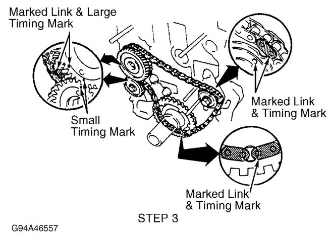

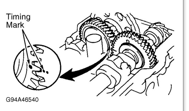

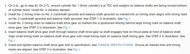

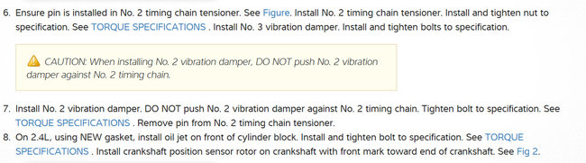

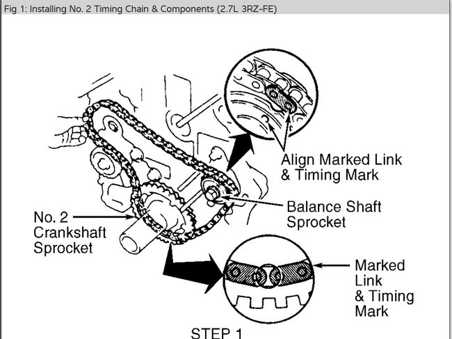

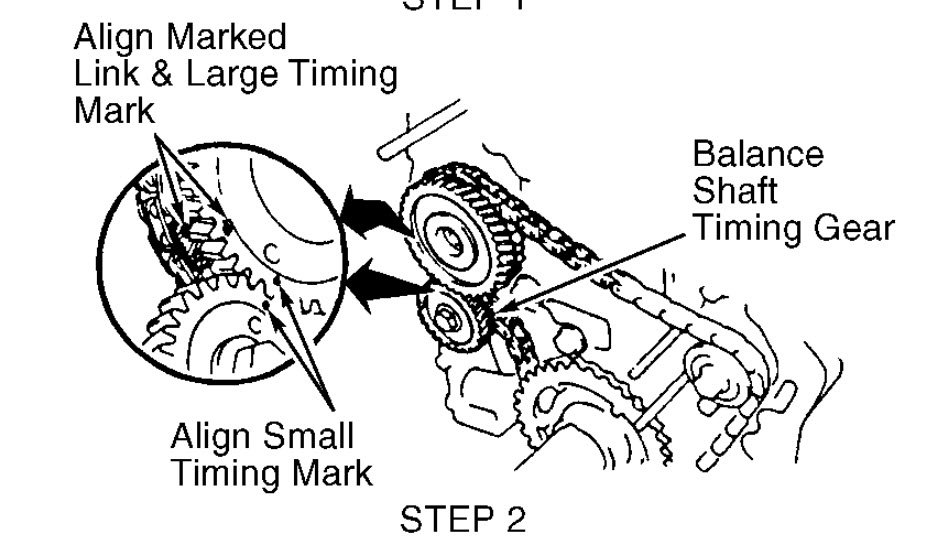

Timing instructions please.
Dec 24, 2016 at 5:51 PM
HMAC300
  • 48,601 POSTS
see pictures for instructions.
