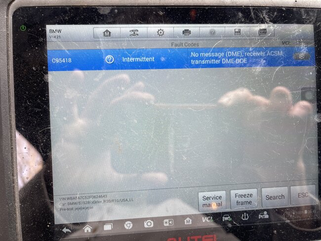

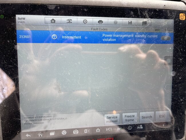

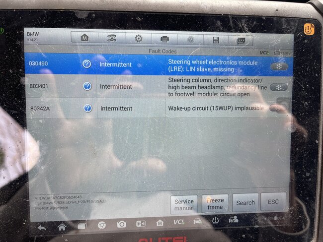

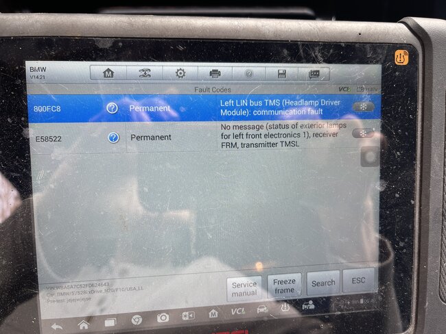

bought this 15 model AWD 528i. Only thing that works on the left light is the blinker. I also see moisture in it. Not sure if the whole light assembly would need to be replaced or some parts that control everything inside could be replaced. It had several codes first, deleted all and these only one that are/maybe related. I tried activating any of the lights on this left side and nothing came on.
Jan 29, 2025 at 8:10 AM

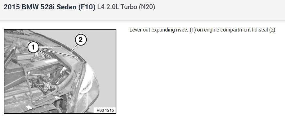

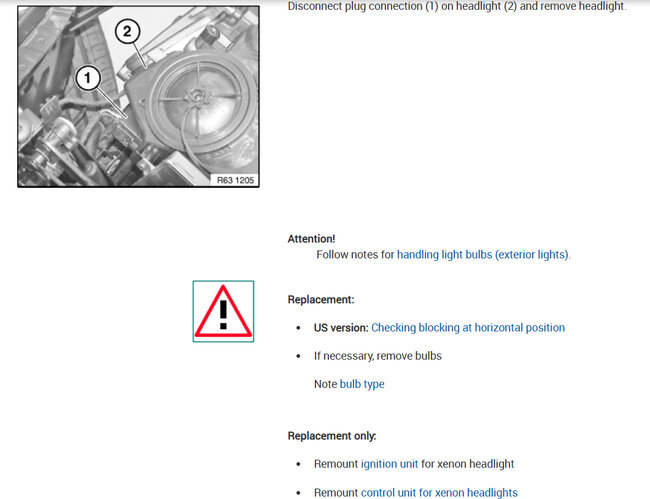

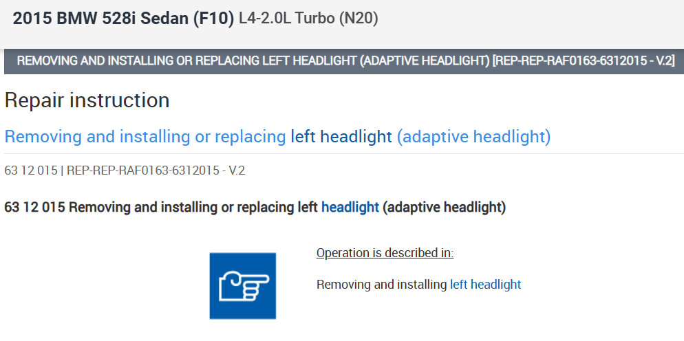

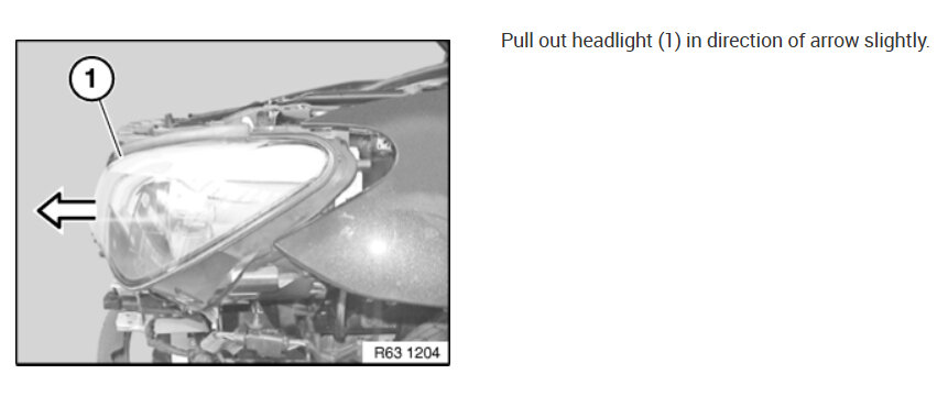

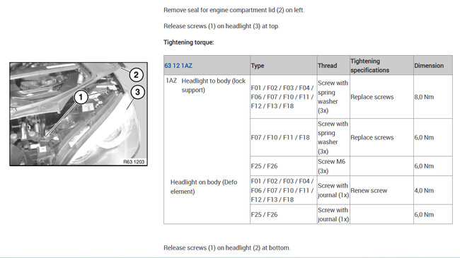

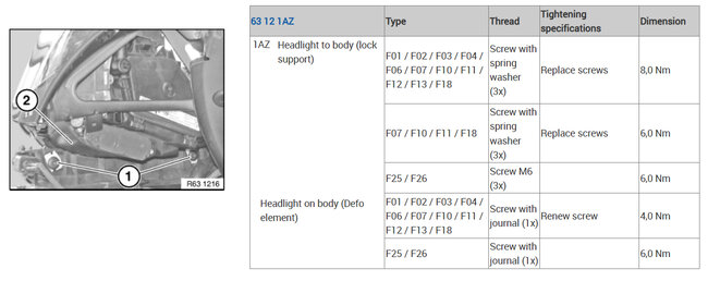

The 800FC8 code is the clue, also water in the head light is not good. I would remove the left side headlight lens and check it for damage, then I would get a used lens from eBay which will have the module with it. then clear the codes and the problem should be fixed. Here is how to remove the headlight lens. Check out the images (below). Please let us know what happens.
Jan 29, 2025 at 10:41 AM

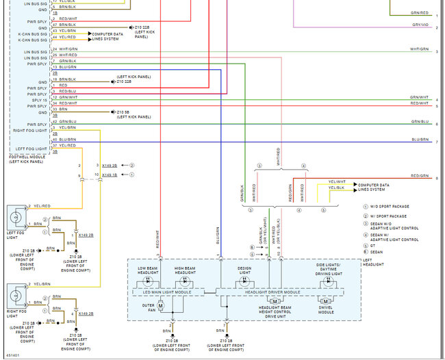

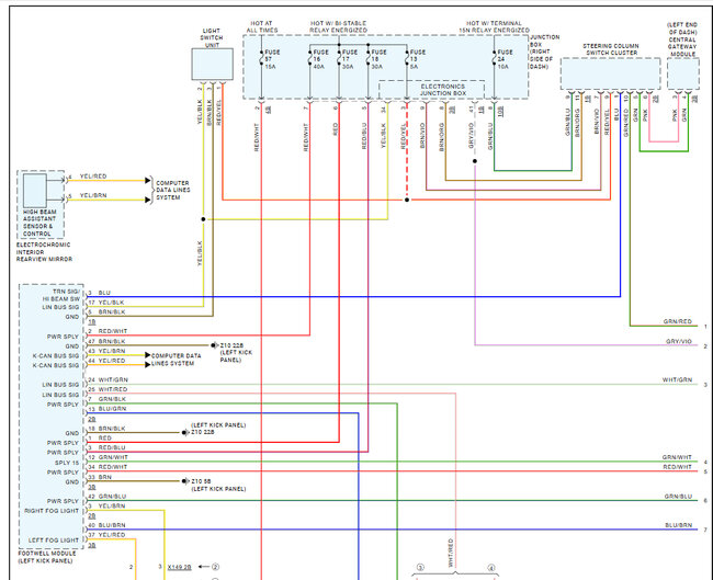

Power for the headlight is red/wht, here is the left headlight wiring daigrams so you can see how the system works. Check out the images (below). Please let us know what happens.

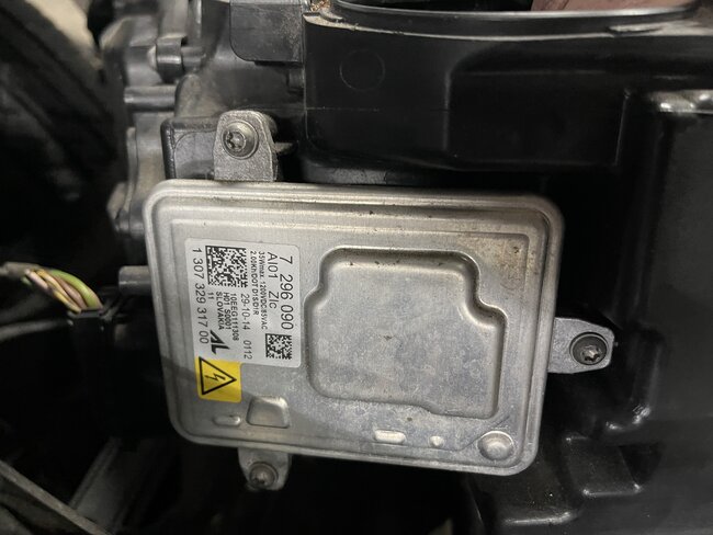

Changed TMS and didn't solve it. What else could be wrong? Is this a module? It's on the side of the headlight.
Feb 2, 2025 at 6:07 AM
Yes, you must swap out the headlight module as well.

someone tested that power wire before because i see evidence of trying to pinch it via a tester light. There is power and ground. i removed that module but there is no evidence of any corrosion. i put it back. removed the xenon bulb and found out i have one in the garage. turn the lights on and the low beam came on. I think that module i showed u last controls the halo rings. i ordered one.
Feb 2, 2025 at 1:05 PM
Sounds good, that should fix it.
