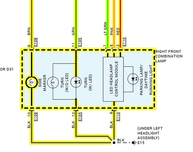

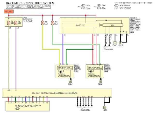

This is the OE diagram for the system. Which fuse was blowing? Which side of the DRLs is going out? From the diagram it looks like the issue could be a bad lamp module.

OK, the Black wire is a ground, Did the wire get hot before you replaced the lamp? If the module shorted out it might have started pulling a lot of current and melted the ground. Does the fuse open or the wiring get hot with the replacement lamp or was that with only the original lamp?

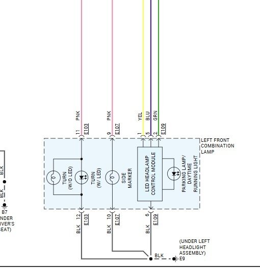

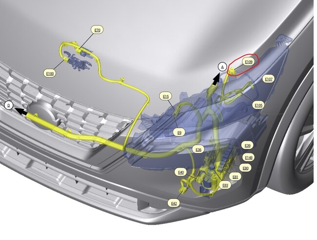

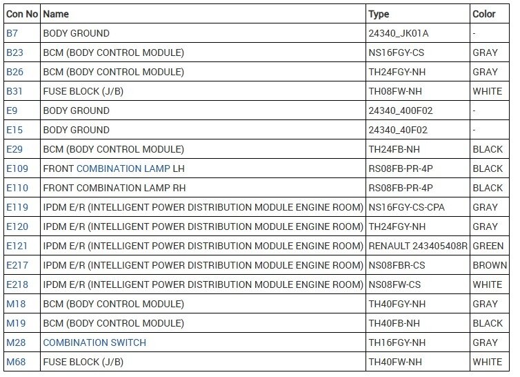

E109 it seems
Aug 18, 2025 at 5:15 AM
STEVE W.
  • 15,116 POSTS
OK that one goes into a splice and then out to the ground point under the headlight. It's a mess but I would open up the harness and trace it to the opposite end. That would be the only way to be sure it isn't causing other problems. Then run a new wire from the terminal on the light to a good ground and see if the light now works. If it still gets hot it could be that the replacement is defective. Not an uncommon thing with aftermarket parts. I've seen new parts that were wired wrong.

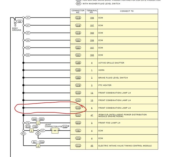

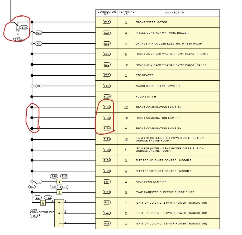

The second photo shows E109 on the drivers side, is that accurate or just the same on both
Aug 18, 2025 at 8:18 AM
STEVE W.
  • 15,116 POSTS
Both sides end up at the same ground point. I just grabbed the least cluttered side for you. The ground on the right side is E110 pin 6, goes from the light to a splice and across the car to the E15 and E9 ground point, basically everything on the harness goes those two points, which set next to each other, but they don't show where the actual splices are unfortunately.
