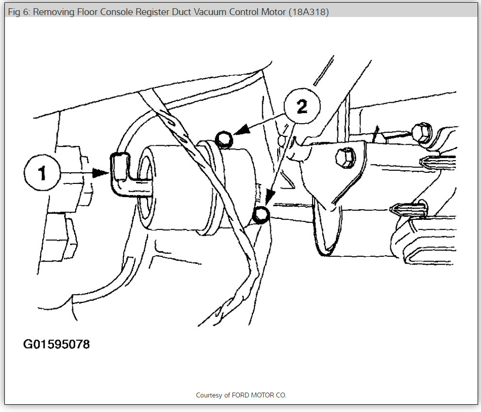

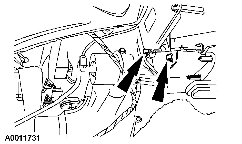

Yes, there is a blend air door that controls the air temp coming into the vehicle. What I would recommend is to simply check to see if it is working. Remove it and change the temp at the dash and see if it moves. If it doesn't, replace it. Also, when you take it apart, confirm the linkage between the actuator and door is attached.

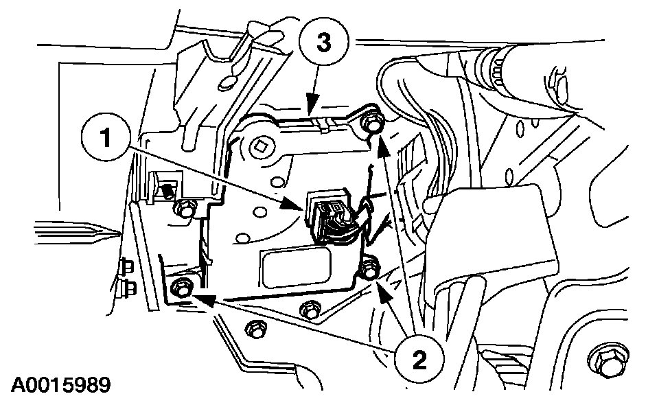

Here are the directions specific to your vehicle. This isn't a bad one to access. The attached pics correlate with the directions.

2004 Ford Taurus V6-3.0L DOHC VIN S
Temperature Blend Door Actuator
Vehicle Heating and Air Conditioning Air Door Actuator / Motor Service and Repair Procedures Temperature Blend Door Actuator
TEMPERATURE BLEND DOOR ACTUATOR
REMOVAL
pic 1

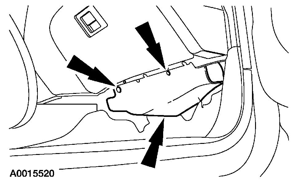

1. Remove the right-side lower instrument panel insulator.
pic 2

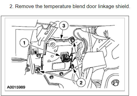

2. Remove the temperature blend door linkage shield.
pic 3
3. Remove the temperature blend door actuator.
1 Disconnect the electrical connector.
2 Remove the screws.
3 Remove the temperature blend door actuator.
INSTALLATION
1. To install, reverse the removal procedure.

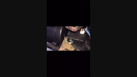

Back with the same issue I have had since I have owned my car: no heat. I have replaced the thermostat, the heater core, did a coolant flush, coolant is bright green, replaced my blend door actuator. So I am pretty sure I know what the problem is I just need tips. I have read online about a blend door “hack”, basically manually turning the blend door in order to change the temperature from hot to cold or vice versa. I am pretty sure the actual HVAC blend door is the problem because whenever I turn the knob to the hot side, I hear very clearly a slip inside the AC box, as if the blend door would not engage all the way. So I have read on how you can cut a hole in the side and stick your hand in there and move it that way. I just need more tips and i need to know if that is an efficient method and exactly how to do it.

Yes, I think the blend door actuator is bad which is common. Here is a guide to help you see what you are in for when doing the job:

My only question is how could it be the blend door actuator when I see that it moves whenever I turn the knob from hot to cold and vice versa, the plastic tube that sticks out from the actuator rotates and functions, but I do hear a slip and a knock from what seems like the inside of the HVAC box whenever I turn the knob to hot. Just to be more detailed, I’ve added a video to show you exactly what happens

thank you got it fixed
