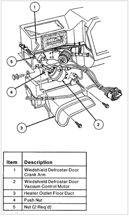

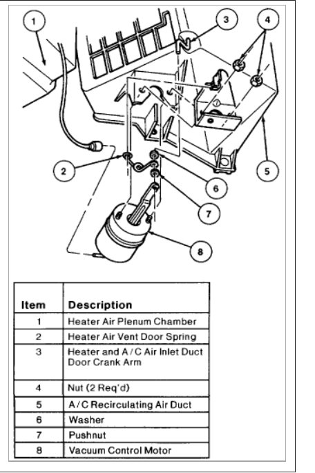

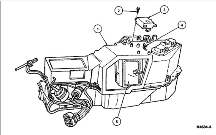

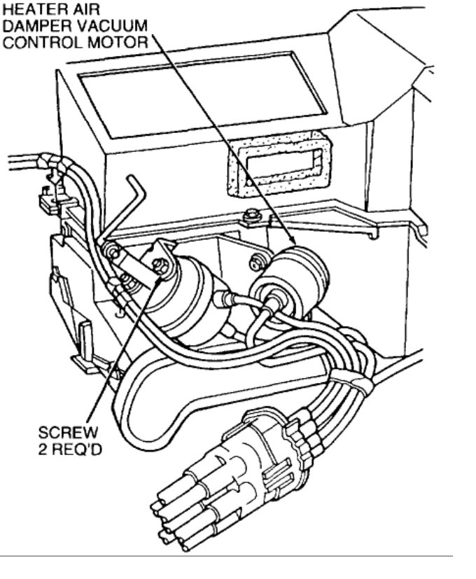

RASMATAZ
  • 75,992 POSTS
Your car does not have a heater control valve the problem is most likely the temperature blend door actuator has gone out and needs replace. Here is a guide that will show you what you are in for when doing the repair.
Here is another guide that can help
https://www.2carpros.com/articles/car-heater-not-working
Here is the location of the temperature blend door actuator for your car (below)
Also check for vacuum leaks under the hood this guide will show you what to look for
https://www.2carpros.com/articles/air-vents-stay-in-the-defrost-position
Cheers
