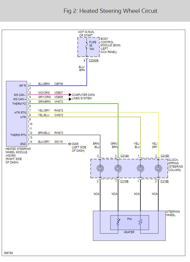

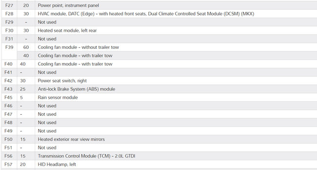

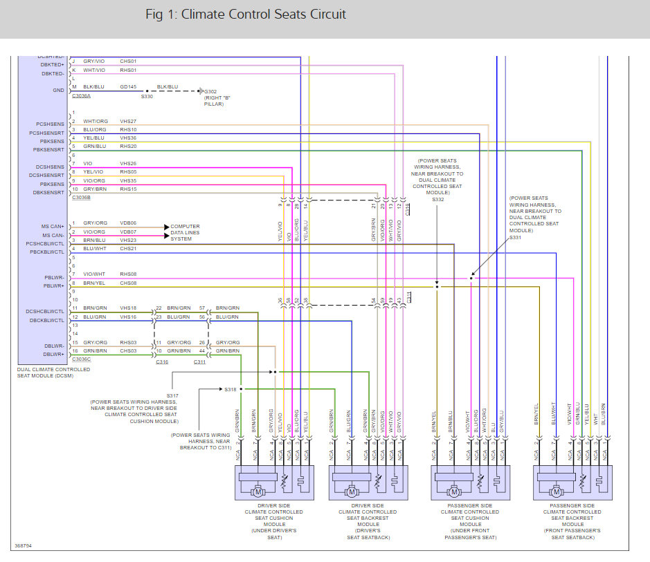

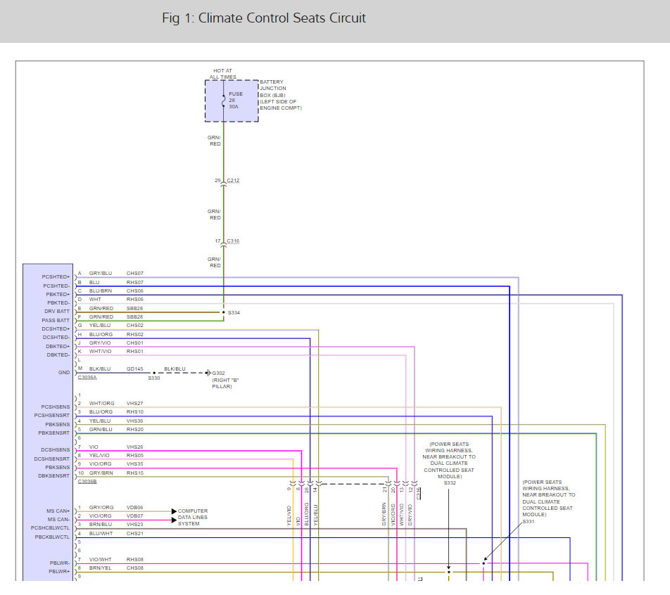

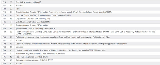

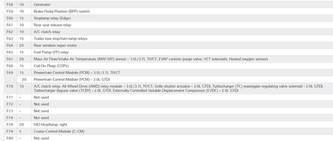

It sounds like you need to check fuse #28 that power the heated and cooling seats. Here is a wiring diagram so you can see how the system works and a guide to help check the fuses:

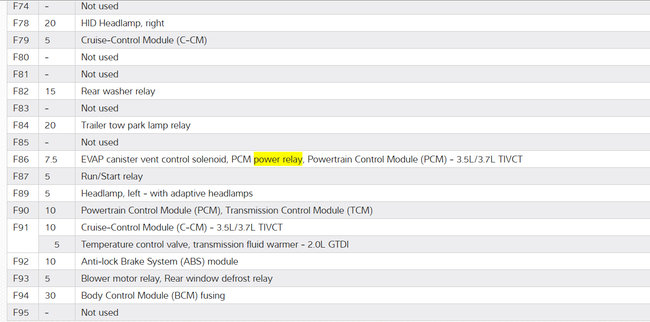

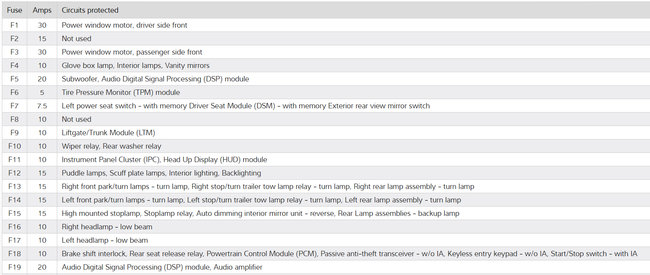

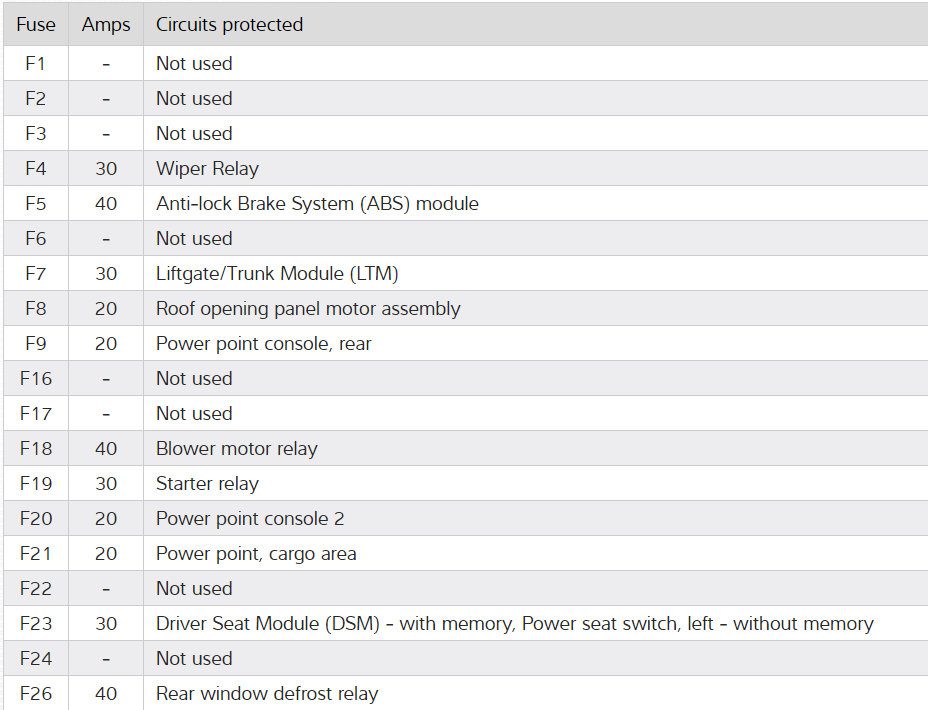

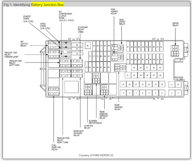

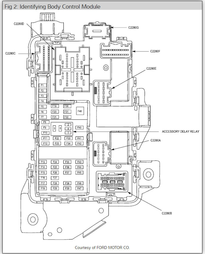

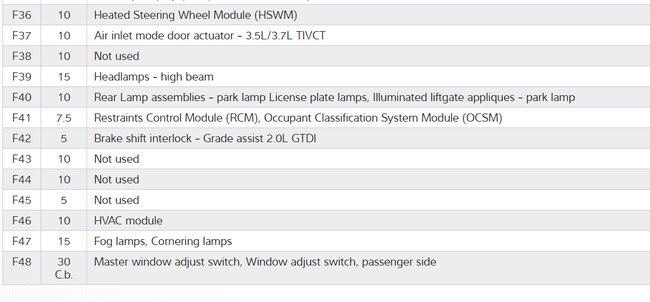

Here are the fuse locations as well.
Check out the diagrams (below).
