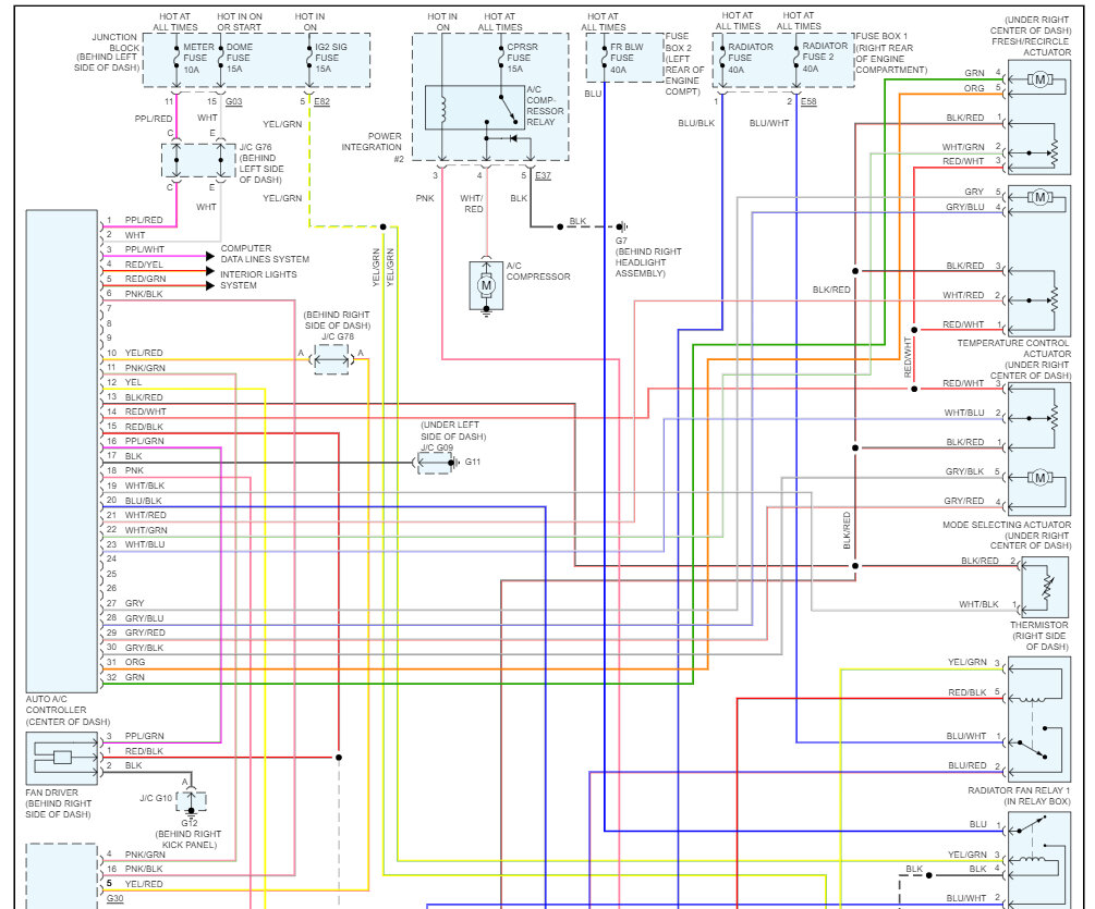

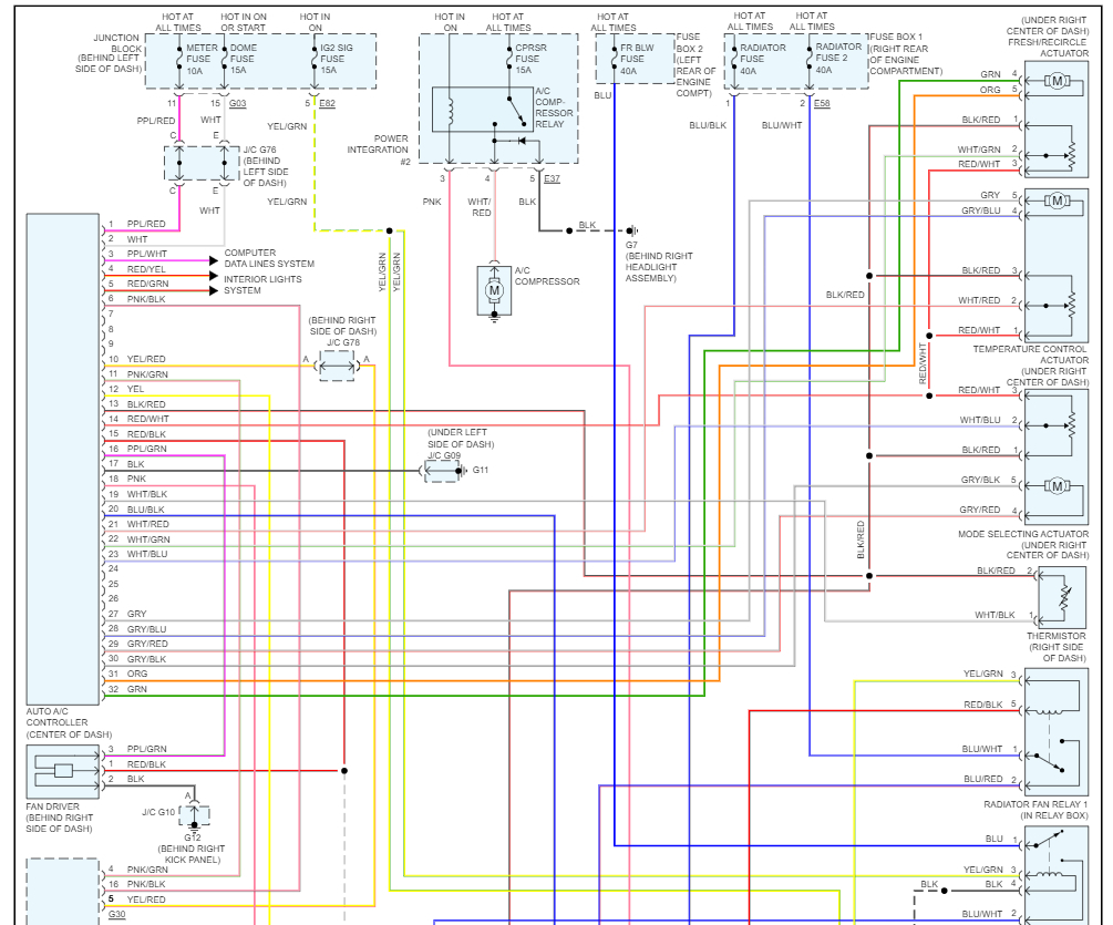

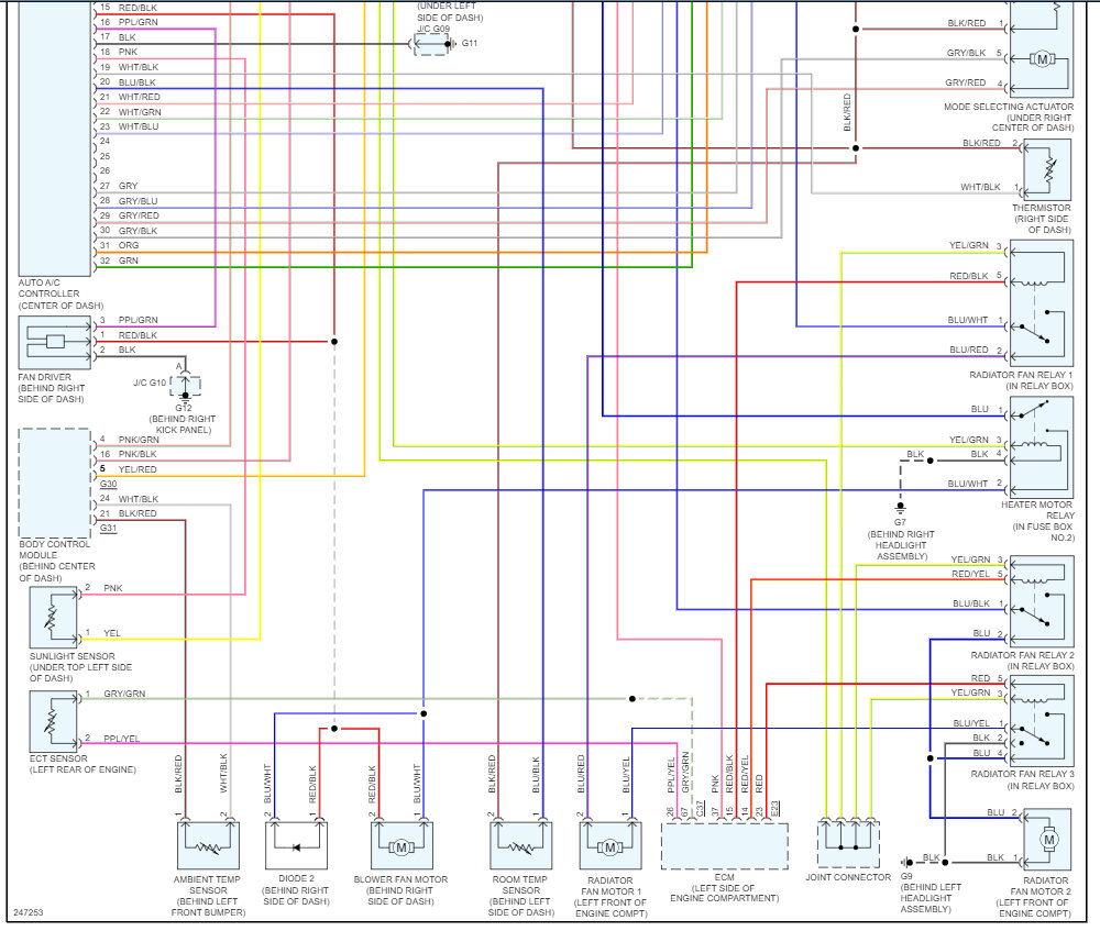

First, I would check for blown fuse #2 in the fuse panel in the engine bay. Next, I would check the ground g12 behind the right kick panel. Here is a guide to help you test for power and ground at the blower motor:
