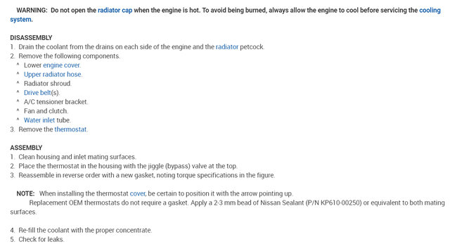

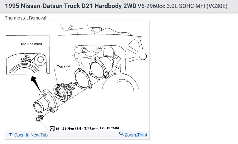

It sounds like you have found the problem is that the thermostat is stuck open which will not allow the coolant to get hot enough for the heater to work and it will cause the lower radiator hose to be cool as well. Here is a generic guide to help you step by step with instructions in the diagrams below to show you how on your car:
And this guide may help as well:
