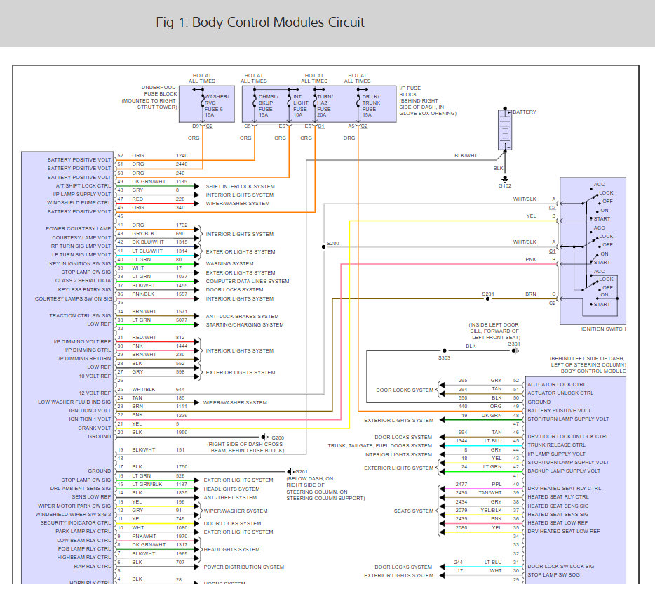

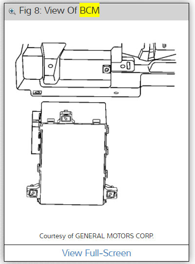

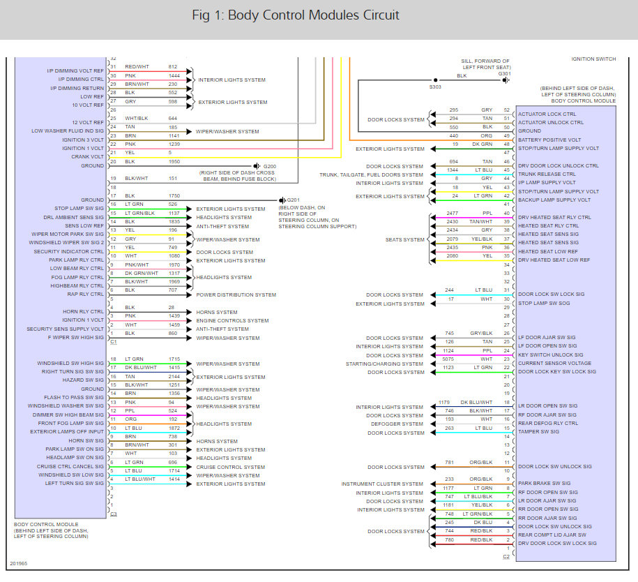

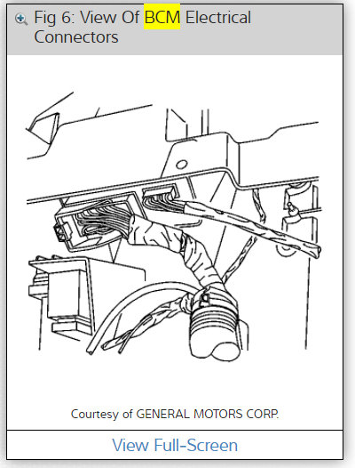

To me this sounds like a bad ground for the BCM or the BCM is going out. Here is a BCM wiring diagram (below) But to make sure its not one of the 5 fuses that control the BCM we should test those first.

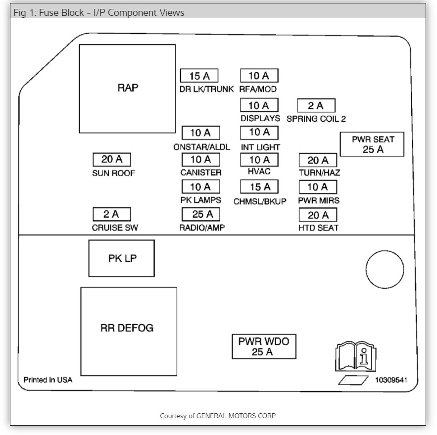

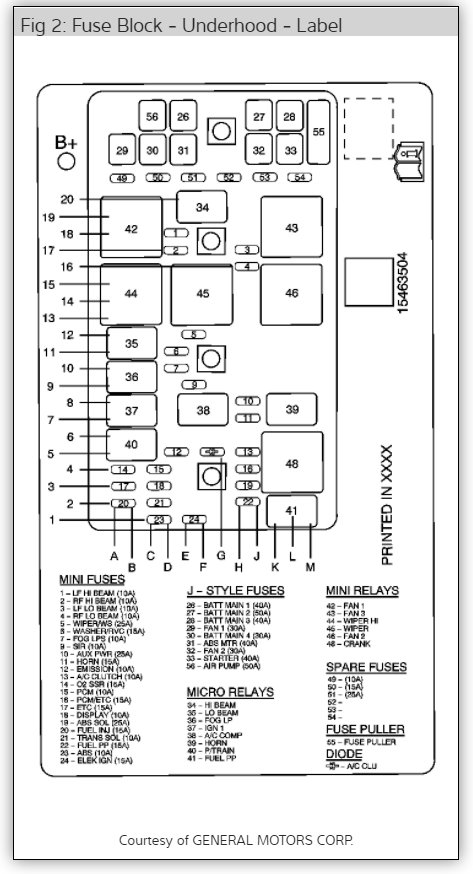

Here is the fuse locations as well (below)
