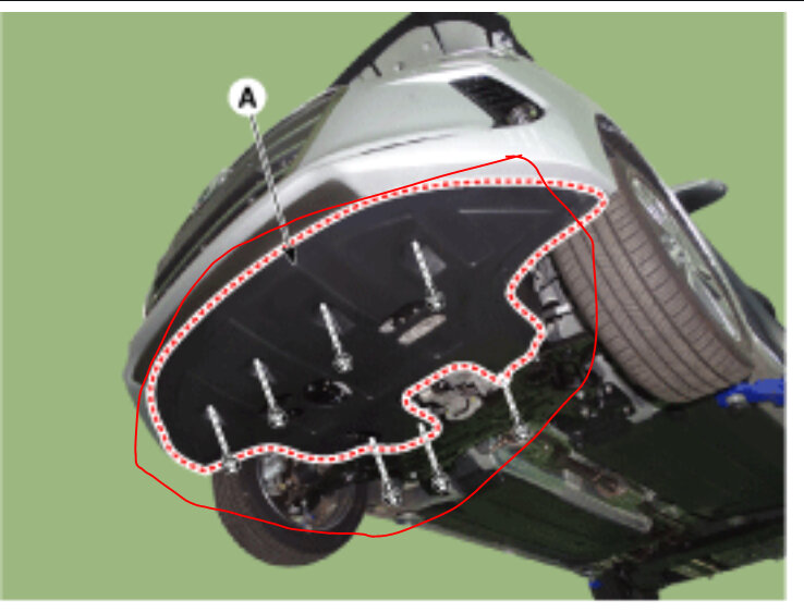

The first thing that comes to mind is the engine plastic undercover. See pic below.
Check to make sure that it is secure. Oftentimes, a shop will loosen or remove it when servicing the vehicle. Then, it will flap in the wind. Also, check the inner fender as well to make sure it isn't loose.
If it is loud enough for you to record, do so and upload it for me to hear.

Lol I was thinking the same thing, but everyone looked at me like I was crazy. And the shop zip tied it back up. So, I will definitely be fixing that properly.

Was that the cause? LOL I'm not sure what else would cause that kind of sound. So, if they looked at you as if you were crazy, they are the crazy ones. LOL

I took the plastic off just to see and it’s still making the sound. So now I’m going to check the inner finder well. And hope it’s that. And I am getting ready to put the cover back under the car now lol. I will let you know if it’s the inner finder well.
