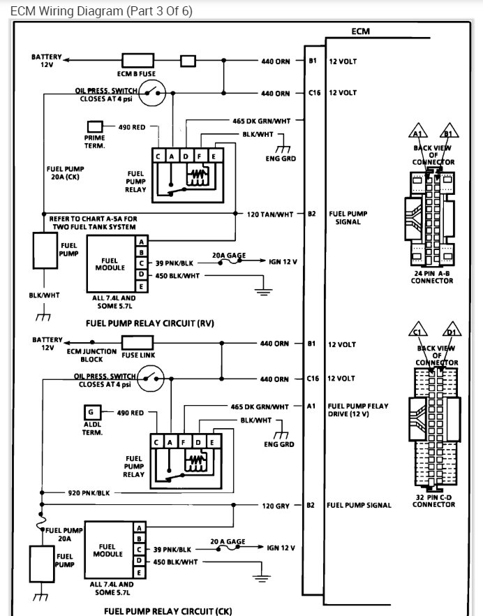

This does sound like a weak fuel pump relay. A relay is nothing more than an electromechincal switch. It can be broken down into two distinct halves, the control side and the power side. The control side is the side on your relay that is probably failing and it consists of an electromagnetic coil. When electricity passes through the coil it energizes and turns into a magnet. The power side consists of a switch that will be sucked closed when the electromagnetic coil energizes and turns into a magnet, allowing electrical current to flow through the now completed circuit. It's like flipping a light switch. Your electromagnetic coil in your your vehicle's fuel pump relay is probably deteriorated through normal where and tear and can no longer maintain energized and is allowing the switch on the power side to open, not allowing electrical current to flow to the fuel pump and killing your vehicle's engine. Here is a link for you to go to:
Please go through this guide and get back to us with what you are able to find out.

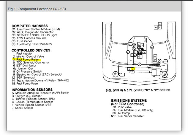

Did you guys install a new fuel pump relay? I have included a diagram of where the fuel pump relay is located in your vehicle. Please get back to us.

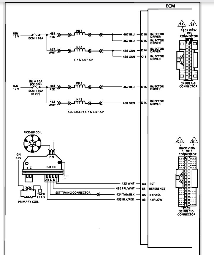

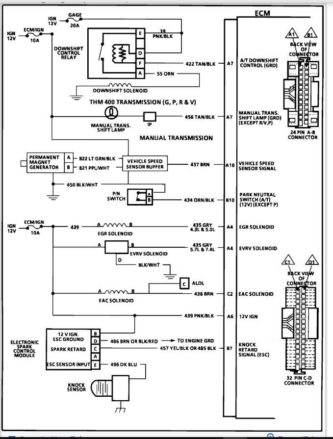

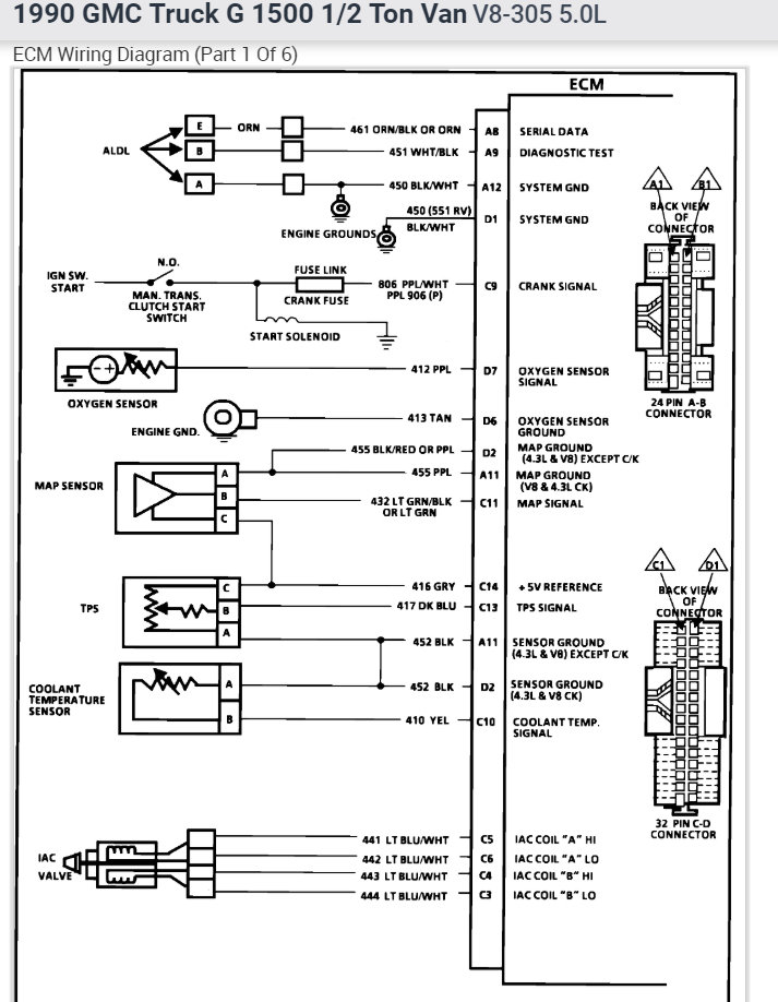

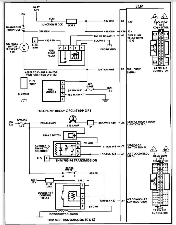

When the engine stalls can you see if power is getting to the ECM. Check b1 and c16. here is a guide to help and the engine wiring diagrams so you can see how the system works:
