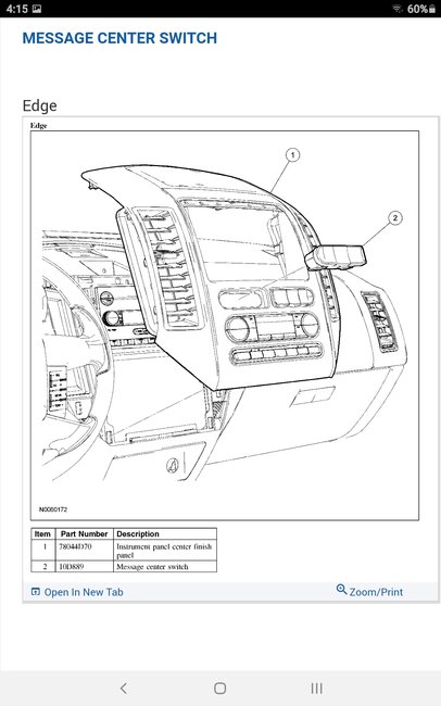

Your center dash will pop right out and you will be able to get to the mounting screws to get the radio out. The clip are at the four corners of the panel. Here is a picture that shows the clip locations.
Pull the instrument panel center finish panel straight out to release the retainer clips and remove the instrument panel center finish panel.
- Disconnect the electrical connectors.
Press the 4 retaining tabs and remove the message center switch.
To install, reverse the removal procedure.
