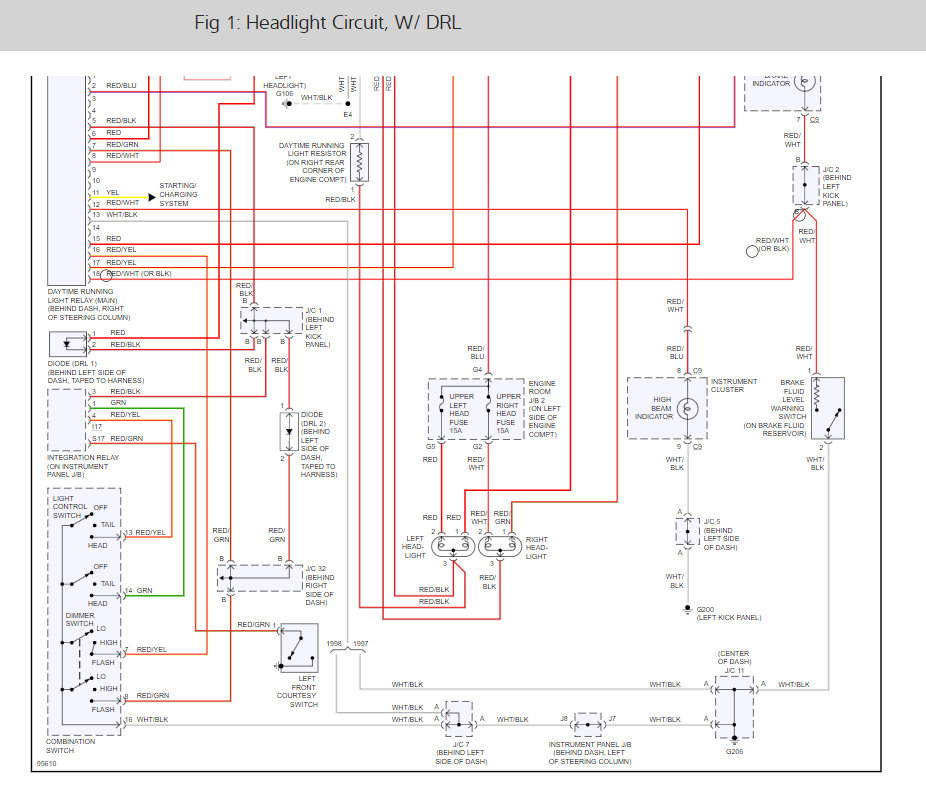

It does sound like the headlight switch is bad. To be sure here is a guide to help us check for power and the headlight wiring diagrams so you can see how the system works and which wires to test for power when the switch is on:

Also the diagrams you sent are a bit un familiar.
But I assume most of it is just because right hand and left hand drive cars maybe.

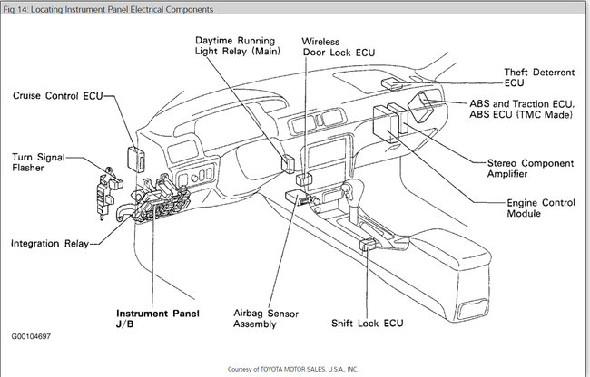

Yeah it did not help too much. Although I will try tomorrow to find the day time running rely as mentioned on one of diagrams.

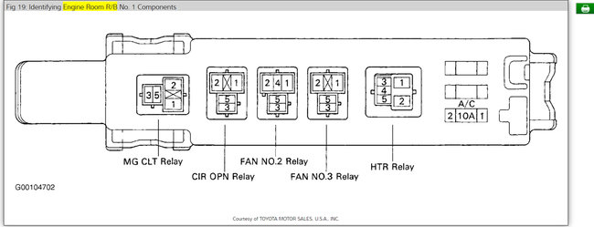

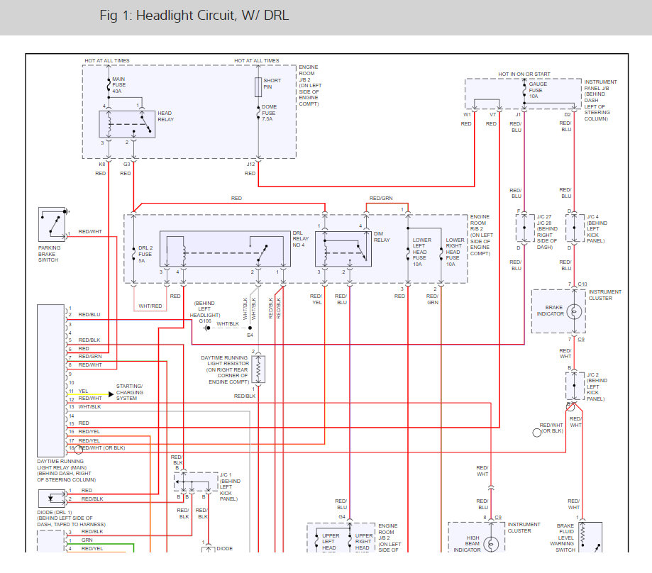

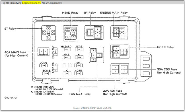

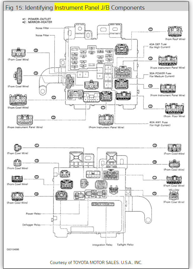

Please check the grounds of the system as well. Here are the relay locations. Check out the diagrams (below). Please let us know what happens.
