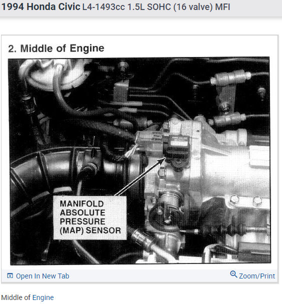

I need to know where the map sensor location for a 1994 Honda civic ex
Jun 11, 2010 at 5:56 PM
SQM
  • 6,383 POSTS

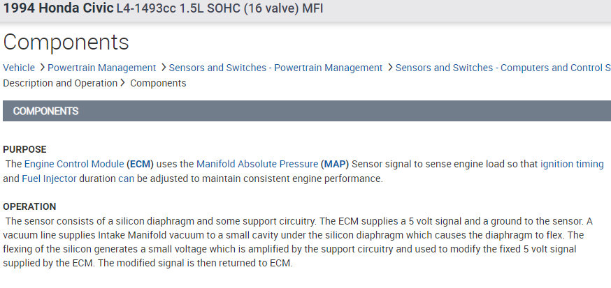

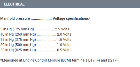

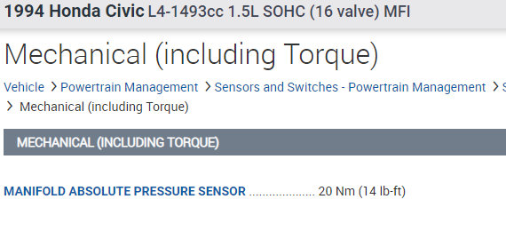

The MAP sensor is located on the top of the engine. See attached picture. I have also included few other specifications.
Let me know if you have any questions.
