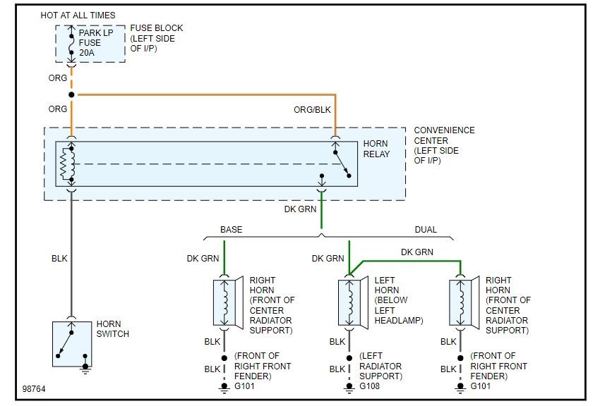

I attached a wiring diagram for you to view. The fuse is shown with the location.
Image (Click to enlarge)

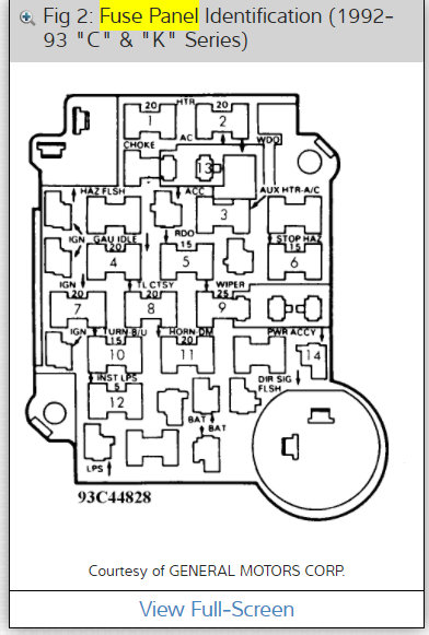

Here is the fuse location which is under the dash. This guide can help you test the fuse:
