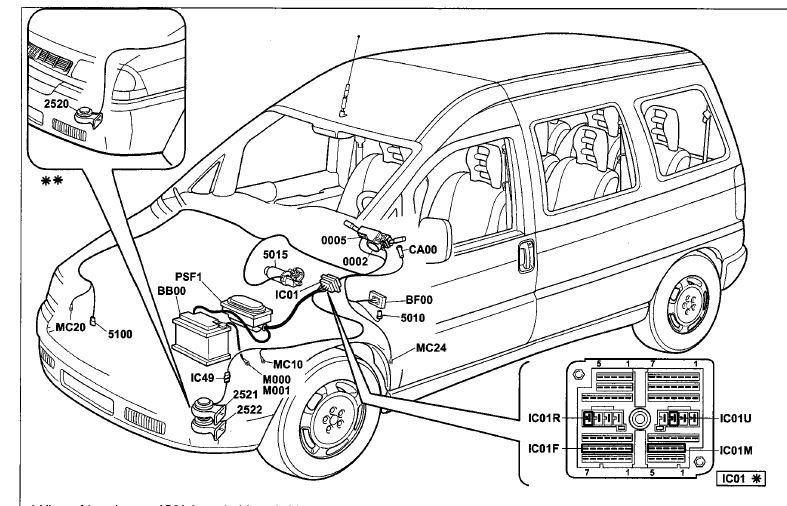

The horn on my vehicle Expert has stopped working.i have checked the fuse in the glove box, which is fine. I cant find the horn. .I've seen online that its meant to be behind the passage headlight but cant see it. any ideas?

About the easiest way to get to it is to remove the front bumper cover enough to get into that area. Unfortunately access to factory information on them is scarce. The image should show the location and you may be able to see them from under the vehicle. The rest of the manual doesn't tell how to access them.

Hi Steve, found it right behind the fog light and I can get to it from the wheel arch.
Just about to order one to replace it.
