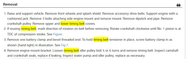

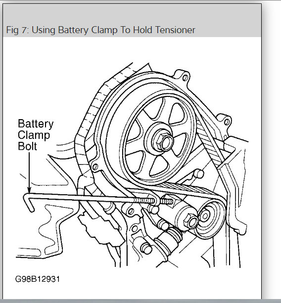

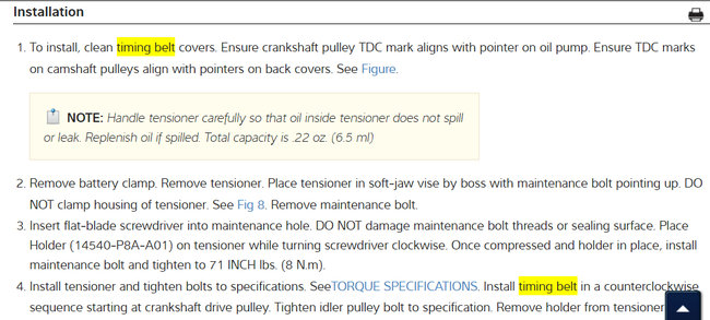

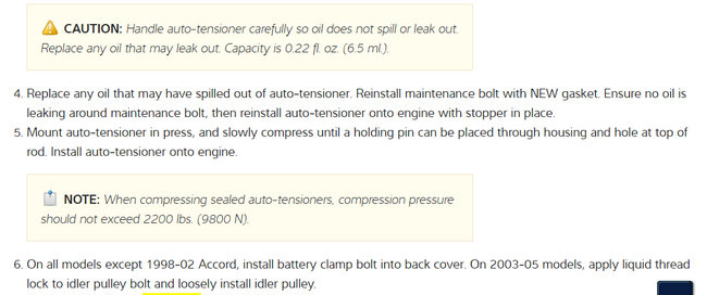

How can l change a timing belt?
Apr 3, 2019 at 7:39 PM
SCGRANTURISMO
  • 4,897 POSTS

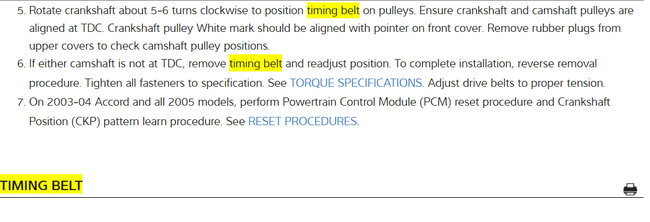

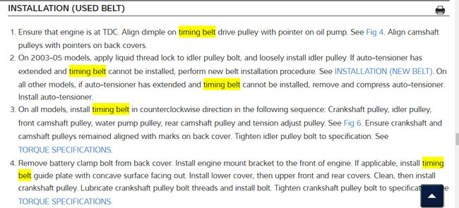

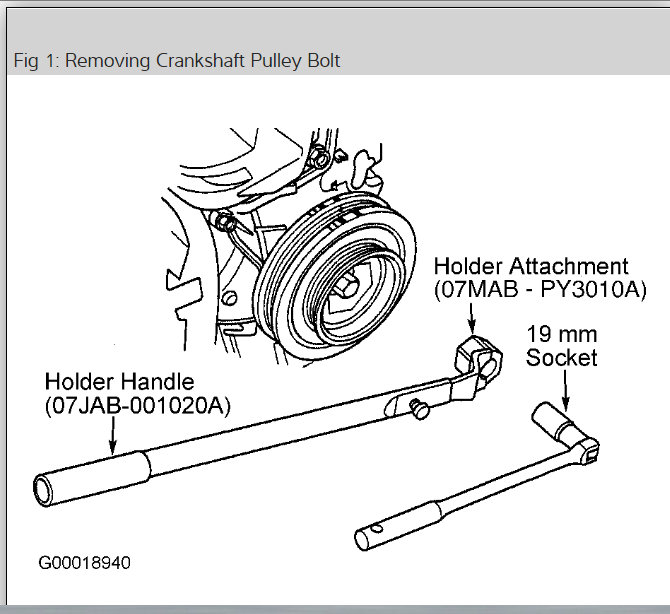

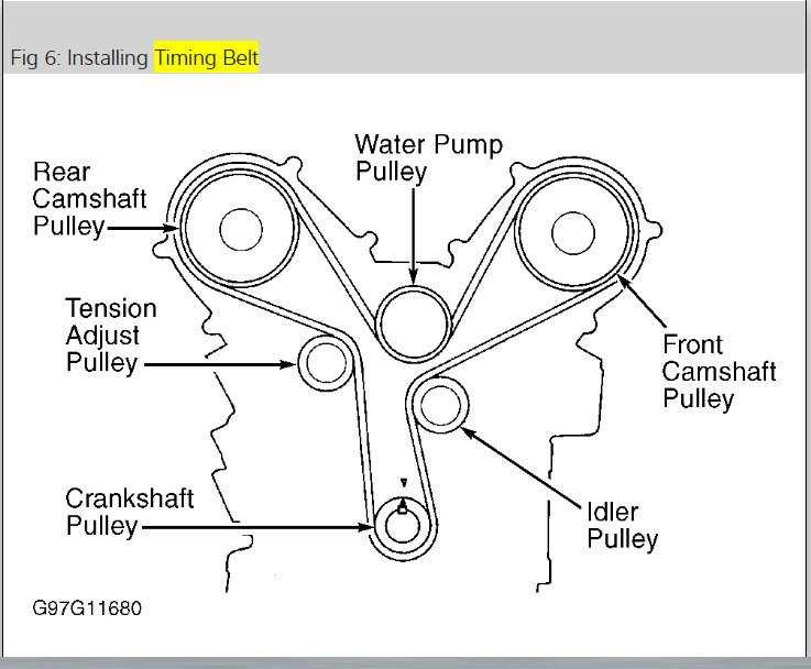

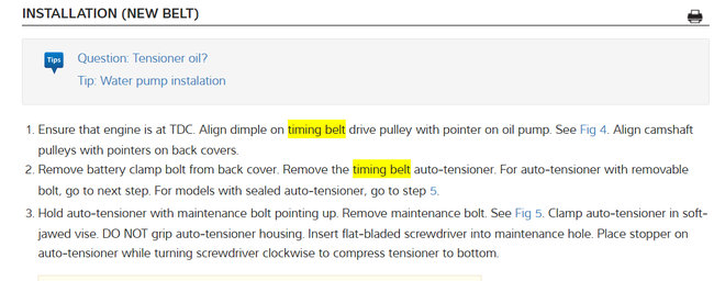

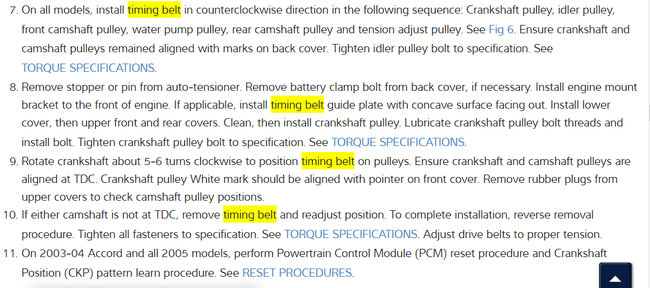

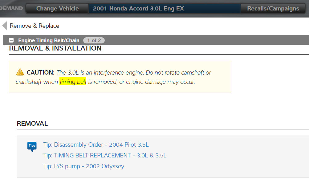

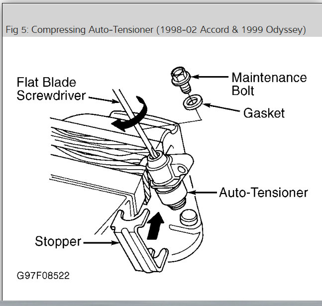

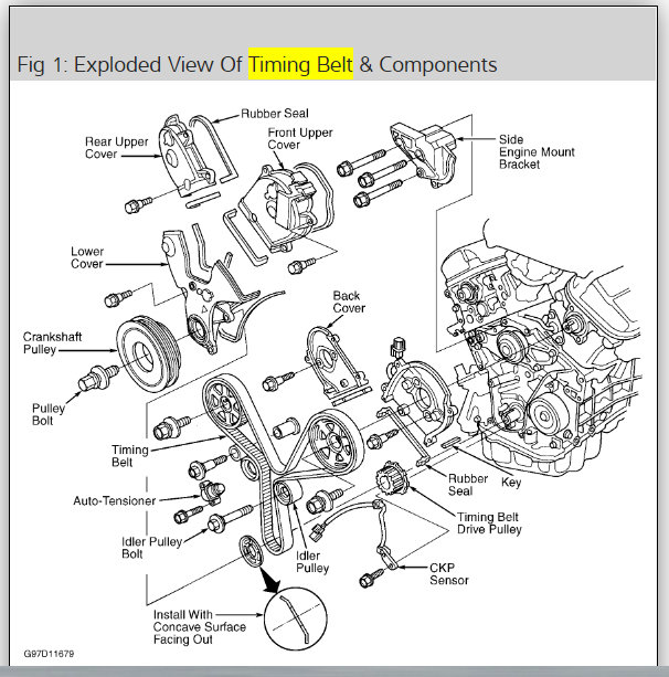

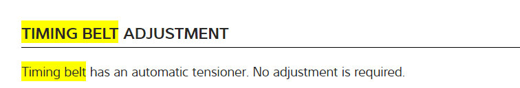

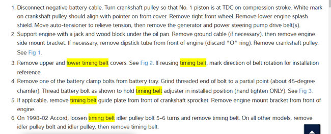

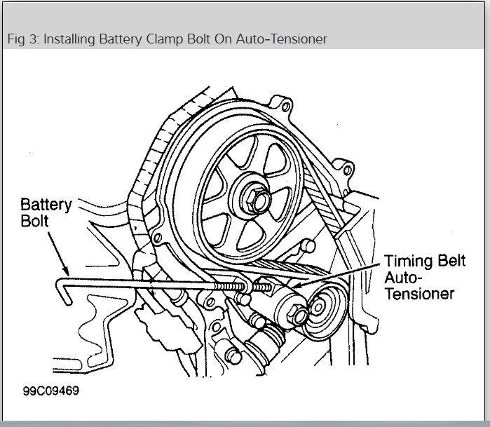

I have included the information that you requested in the diagrams down below. Please go through the factory installation guide provided to you and get back to us with what you find out. Here is a guide to help you step by step with instructions in the diagrams below to show you how on your car.
https://www.2carpros.com/diagrams/honda/accord/2001
If you have any other questions please feel free to ask. That is what we are here for.
Thanks,
Alex
2CarPros

There are two belts on this engine, a timing belt and a balance shaft belt. There are special tools required, mainly to locate and lock the balance shaft in place. Reading the manual it is a bit on the tricky side to do if you have never done this type of job before, considering the special tools involved, i would get your mechanic to quote the job first.

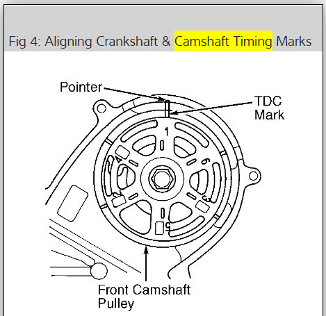

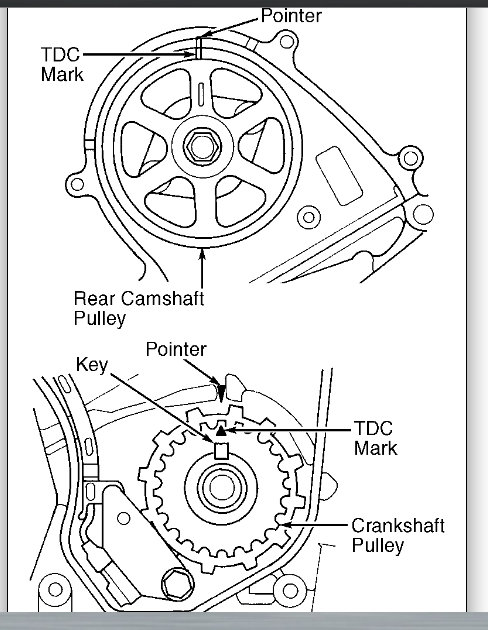

need timing belt marks for 2001 honda crv
Jan 11, 2021 at 5:13 PM (Merged)
DOCFIXIT
  • 18,828 POSTS
Here is a guide and diagrams below to help show the engine camshaft timing marks.
Cheers

Back in the '80s Honda recommended the belt be replaced at 75,000 miles, . . . and they commonly broke at around 65,000 miles leading to a REAL expensive engine repair. They use an "interference" engine which means when the timing belt breaks, the open valves are hit by the pistons as they coast to a stop and become bent. You'll need new valves and a since the cylinder head has to come off, you'll get a new head gasket too. Independent mechanics can replace the belt but if proper procedures aren't followed, some valves can still be bent. Anyone with a little experience can handle the job. $1200.00 seems awfully high. They most likely plan on replacing the water pump too if its pulley is one used by the timing belt. The extra cost of the part is cheap insurance against a failure later.

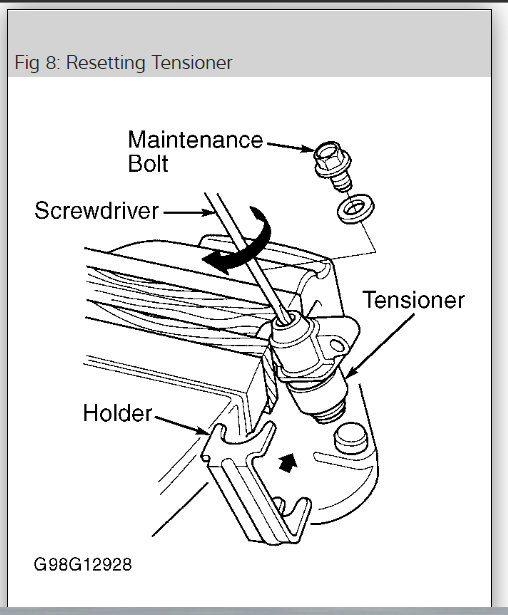

Hi there, Thank you for the donation, This engine has 2 timing belts, one is for the engine balance shaft and if it is not timed correctly you will get this vibration, the balance shaft belt must be removed to take off the engine timing belt, so don't let them tell you that they never touched it. Mark (mhpautos)
https://www.2carpros.com/forum/automotive_pictures/61395_honda_4.jpg
