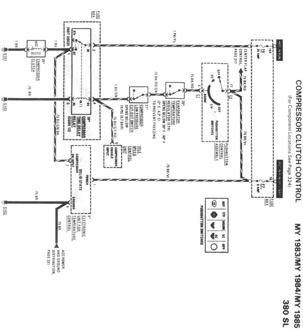

I just installed a new A/C compressor. I have pulled a vacuum and it holds. How do I manually jump the compressor to allow me to charge the system? Is there an alternate method?

I connected the fron supply after the vacuum process and was able to introduce a small of rfreon until it stopped going in. There is no activity from the compressor. On most other cars you can just jump the compressor wiring and the compressor starts up. Is there a way to jump the compresssor relay or the compressor delay?

Look at the compressor wiring, should be a black wire to ground. Put 12 volts to the other wire and the compressor should engage. If you turn the controls to maximum cold it should not take a lot to get the compressor to kick on. As long as the rest of the system is okay.
