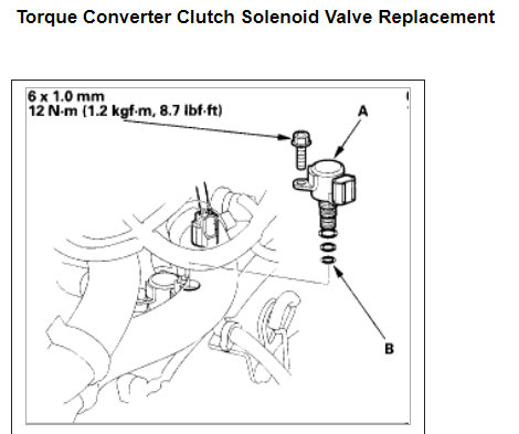

That code is for your TCC solenoid operation malfunction. This can mean the solenoid is not working or the torque converter is having a problem. I would try the solenoid first. Below is its location.

https://www.partsgeek.com/assets/rep/full/1035607.jpg is this the part?
Jan 6, 2018 at 2:29 PM
Sure looks like it
Jan 7, 2018 at 10:24 AM
ANDREWJACK305
Can u please look it up n tell me please
Jan 7, 2018 at 9:25 PM
Yep that is the part.
