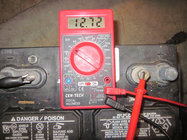

Part 1 Measuring Voltage

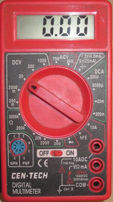

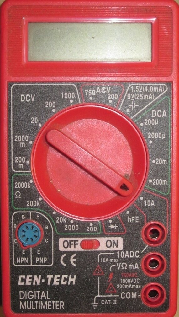

Photo 1 shows the inexpensive digital meter from Harbor Freight Tools. Home Depot has an identical one in yellow. These can also be found at Walmart and any hardware store.

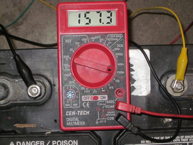

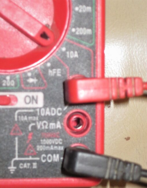

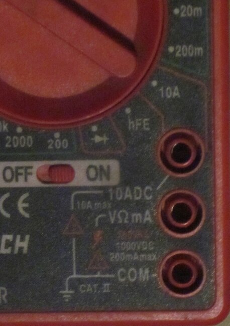

Meters in this price range commonly have three jacks for the probes. Photo 2 shows them in more detail. The black, negative probe goes in the bottom jack. That one is used for all of the functions and ranges. The top jack is used for the red, positive probe for only the highest current range. This meter can measure up to 10 amps DC. ("DC" stands for "direct current" which is used in cars and trucks, and can be stored in a battery). This meter can not measure AC current which is found in house wiring. The middle jack is used for every other function and range except the 10-amp range. The probes are plugged in to the two jacks used most often in the third photo.

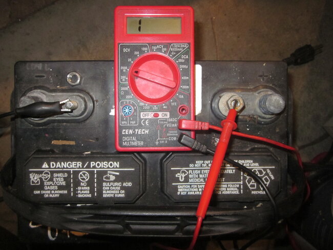

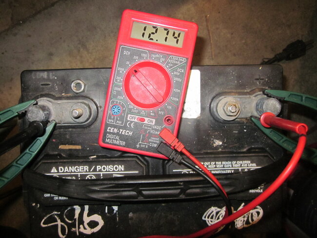

Finally, in the fourth photo, we're measuring this battery's voltage. It takes four hands to hold two probes and run a camera. I only have two, so here I'm using a pair of clamps to hold the probes on the battery's posts. In the fifth photo, it's the same battery and meter, but it's a different negative probe. The probe was broken, and replaced with an "alligator clip". Now only three hands are needed.
The meter is set to the "20 Volt DC" range. That means it can measure any voltage between 0.00 and 20.0 volts. Actually it can only read to 19.99 volts.
There's two common mistakes that will not damage the meter. The first is switching the probes on the battery's positive and negative posts. The display will include a minus sign indicating a negative voltage. Switch the probes to solve that, however, we're usually just interested in the value, not the polarity, so the minus sign can be ignored. The second mistake is using the wrong scale. In the sixth photo, the meter is set to the "2000 millivolts" range, meaning the 2 volt range. It can only measure up to 1.999 volts, but with an extra decimal place of accuracy. The battery has a much higher voltage than can be measured on this scale, so it's showing a "1". Every digital meter has some means of indicating an "over range" condition. This one uses a "1". Simply rotate the range switch to the next higher range.

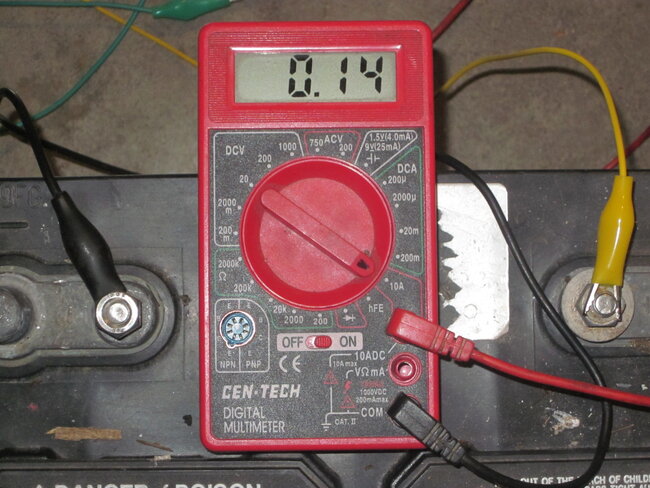

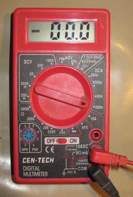

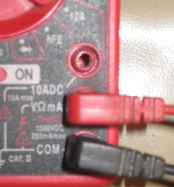

Photo seven shows the meter switched to the 10 amp range. The probes have been added in the eighth photo. The black probe is in the lowest jack, as always, but the red, positive probe is in the top jack. That jack is only used for the 10-amp range. When you need more accuracy and the current will be less than 200 milliamps, photo nine shows the meter set to the 200ma range.
In the tenth photo, current is flowing through a small LED bulb, then through the meter on the 10-amp scale. The value has been rounded off to 0.14 amps. That's 140 milliamps, so it can be measured on the 200ma scale. In the eleventh photo, the meter is on that 200ma scale. The red probe has been moved to the center jack.

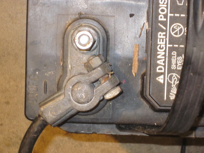

Side note. One battery cable must be disconnected to test for an excessive current drain. When doing this test, when replacing the battery, or when performing any service that requires disconnecting the battery, always disconnect the negative cable first. We do that because if the wrench should contact anything metal on the vehicle while it's on the cable clamp, nothing will happen. If the positive cable is removed first and the wrench makes contact with a metal part, there will be a dead short that could result in sparks, burns, the wrench becoming red-hot, and a serious explosion if the hydrogen gas given off by batteries is ignited. When reconnecting the battery, always connect the negative cable last.

Most meters have an internal fuse for all the ranges except the ten-amp range. To prevent blowing that fuse, start out on the ten-amp range, (Photo 8). If you find less than 0.20 amps, it's okay to switch to the next lower range. Move the red probe to the meter's center jack, and rotate the range switch to the 200ma range, (Photo 9).

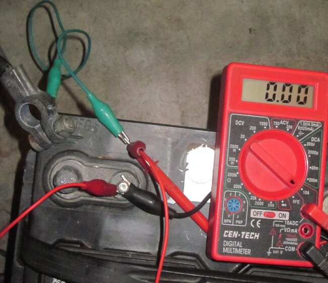

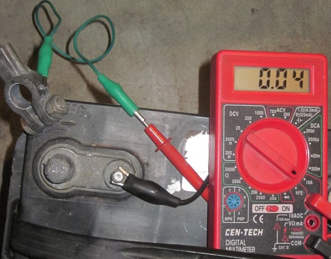

Part 4 Measuring Current in Sleep Mode
By the late '90s, a new wrinkle developed when measuring "IOD current". That's "ignition-off-draw" current. Some is normal to keep the memories alive in the multiple computers. Chrysler says with less than 35 milliamps, (0.035 amp), a good, fully-charged battery will be strong enough to crank an engine fast enough to start after sitting for three weeks. Today that is the industry standard unless specified otherwise by the manufacturer. The new clinker is some computers can take up to 20 minutes to go to "sleep mode". Until then, they can draw as much as three amps. We have to wait until they go to sleep mode before measuring the current drain. The additional problem is if anything is done to break the circuit, then reconnect it, those computers wake up again and will need another 20 minutes to go to sleep.
There's three ways to break the circuit. One is to simply disconnect either probe. The next is when the red probe is moved to a different jack on the meter. The third is much less-known. That is simply rotating the range switch. All meters use a "break-before-make switch design. As the dial is rotated, the internal connection to one range is broken, then, as the knob is turned further, it makes the connection to the next range. That tiny gap is all it takes to wake up the computers.
The extra step required to avoid waking up the computers only takes a few seconds; much less time than it takes to explain it. When you want to change the meter's range, use a small jumper wire to bypass it first. Pick the range you want, then remove the jumper wire.

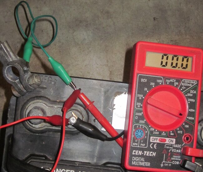

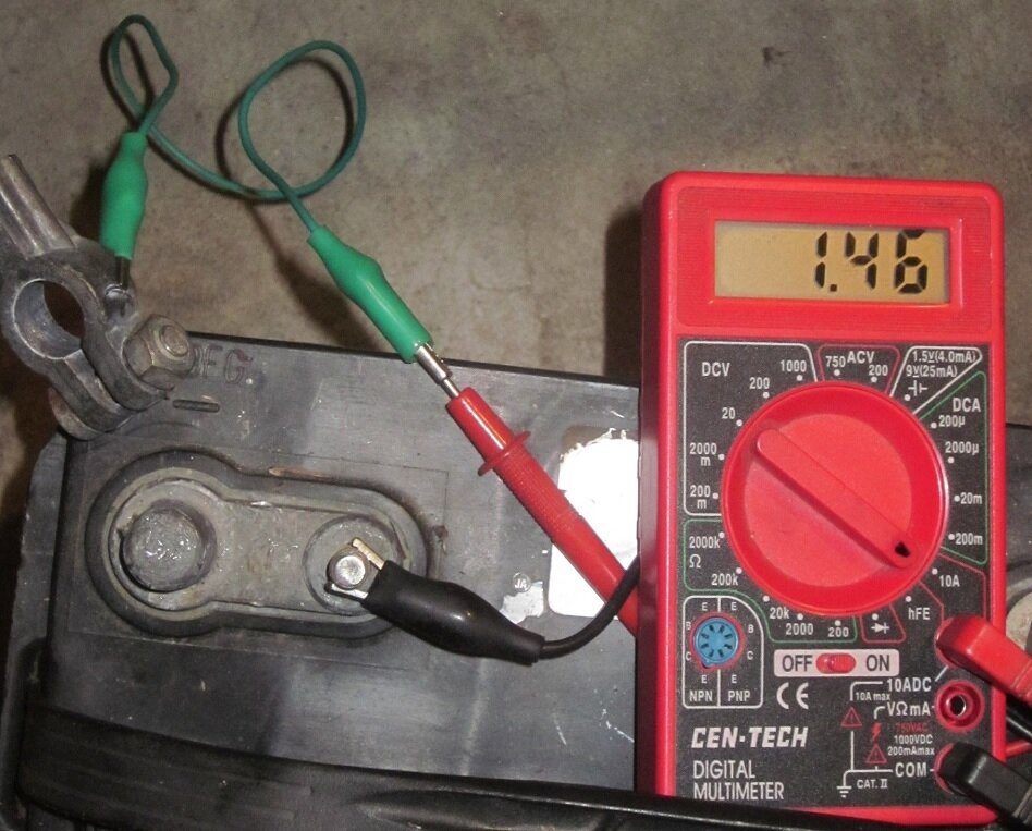

Starting with the 14th photo, the meter and red probe are on the 10-amp range. Current is 1.46 amps. That's too high to measure on the next lower range. After the computers have timed out in the 15th photo, current has dropped to 0.04 amps. That can be measured on a lower range, but that requires removing the red probe to move it to the center jack, and rotating the switch. Both actions will break the circuit and wake up the computers.

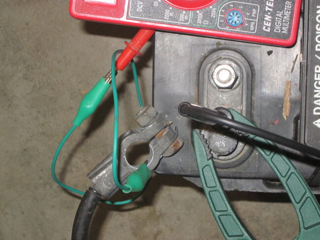

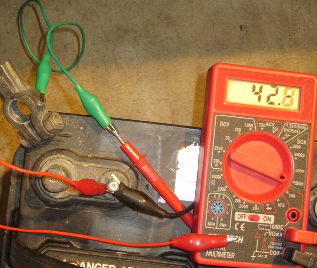

The solution is shown in photo 16. The red jumper wire has been added between the two meter probes. Current flow takes the path of least resistance, so it goes through that jumper wire instead of the meter. That's why the meter is showing 0.00 amps. As long as that jumper remains in place, it's okay to move the probe and turn the range switch. In photo 17, those changes have been made, but current is still flowing through the red jumper wire, so the meter still shows 0.00 amps.
Finally, in photo 18, one end of the jumper wire has been disconnected. Current has to flow through the meter now, and it's showing 42.8 milliamps. This range can measure up to 200 milliamps, (0.200 amps), but it has more accuracy than the ten-amp range. If this current would drop even more, as in below 20 milliamps, the next lower range could be used. That would provide another decimal place to the reading for even more accuracy. To do that, reconnect the jumper wire again, rotate the range switch, then disconnect the jumper.

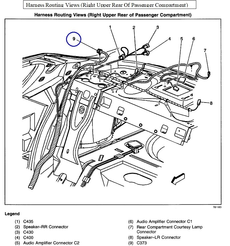

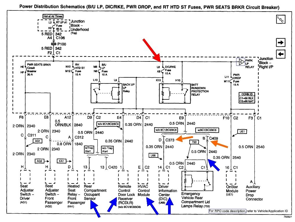

The fuse does blow. The DIC/RKE fuse on the passenger side fuse block 10Amp blows instantly if I connect the trunk courtesy lamp/occupant sensor connector. The owner's manual says DIC/RKE but then in the actual description HVAC is there as well. Oddly enough though when this specific fuse blows, I have no interior lights and the radio doesn't work. But the Driver Information Center still does, and I think the heat too I can't remember. So, I've just been going along without a trunk light because I like having the light come on when i open my door.
Brand new battery like, less than a month old. Every time I have connected to a scan tool it has the same reading.
Anyways i feel like maybe i just answered my own question. Is it the wires in the trunk probably? Idk why there is no headliner so all those wires near the amplifier are exposed. But I rarely use the trunk, so it didn't even cross my mind until just now.

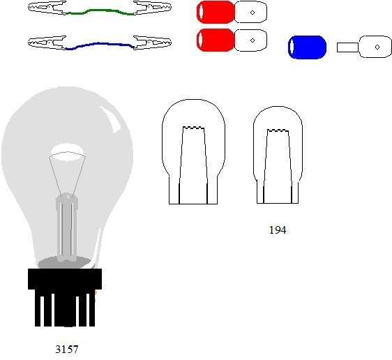

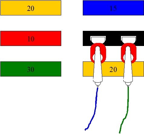

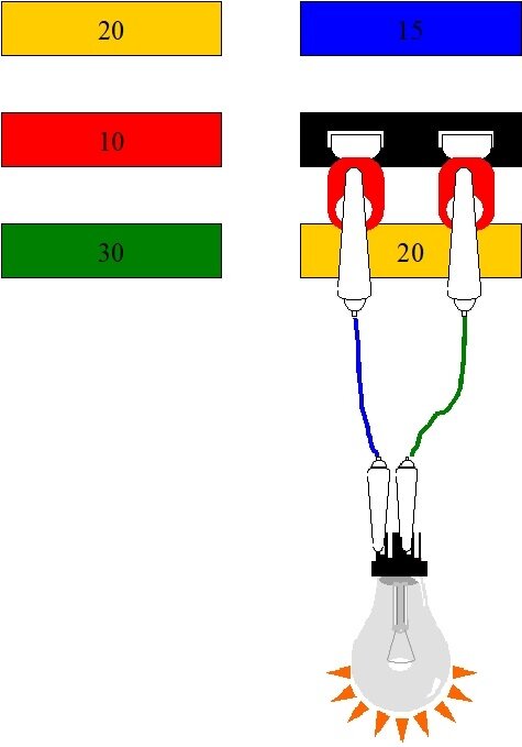

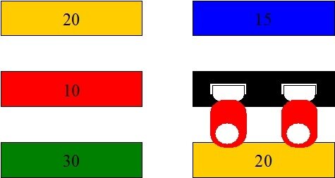

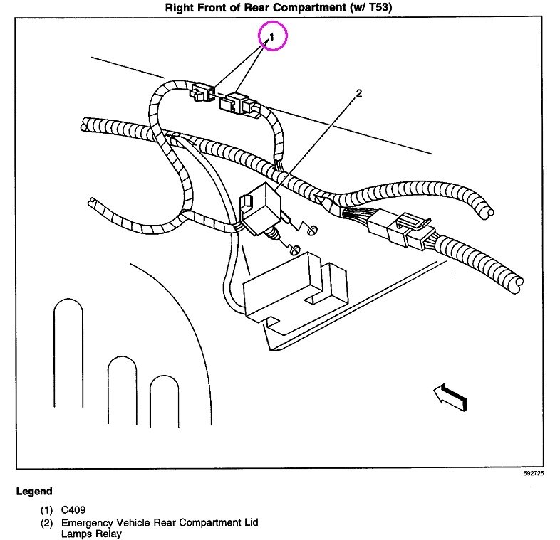

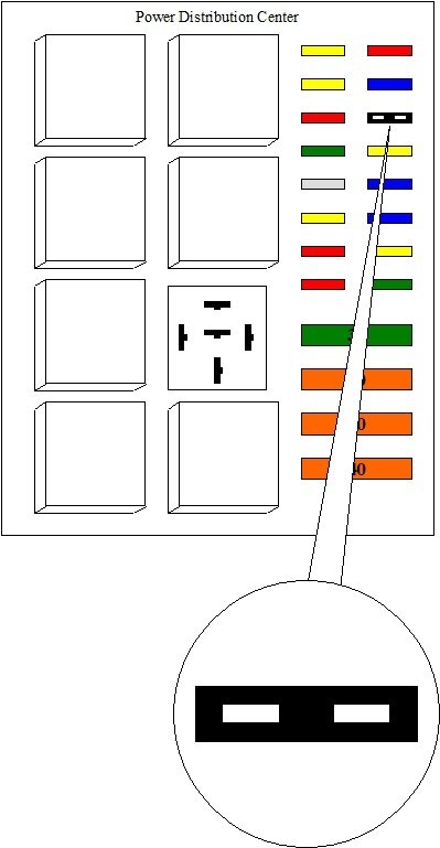

Dandy. This is a horse of a different color. When you have a fuse that continues to blow, my trick is to replace that fuse with a light bulb. When the short is present and the circuit is turned on, the bulb will be full, normal brightness, and hot, so be careful to not lay it against anything that will melt or burn. When you do something to eliminate or isolate the short, the bulb will become dimmer or go out. That bulb will also limit current in that circuit to a safe level to protect the wiring.

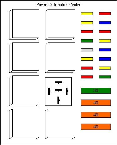

The items needed are shown in the third drawing. I drew a common 3157 brake light bulb. That limits current to one amp. With such a small bulb, once the short is gone, the circuit will resume trying to work, but the bulb is going to prevent normal operation. If you want to, you can substitute a head light bulb for this procedure. Those will allow up to five to six amps of current flow. That is plenty to allow lights to light up enough to see them working, or for a motor to run slowly.
The easiest way to connect the bulb is with a pair of clip leads and a pair of generic, universal spade-type terminals. You can find a dozen clip leads for about three dollars at Harbor Freight Tools. These are available in different sizes. Stick with the smallest ones to insure the alligator clip will fit inside the terminal.
To buy the terminals, you'll end up buying a box of typically 50 or more. Instead, any electronic hobbyist will have many of these lying around. The spade end should be no fatter than the terminals on the fuse. It's common for the wire end to be too small in diameter for the alligator clip to fit in. The blue terminal has the insulating barrel removed by twisting it off. Now just stick the terminals in that way, and clip the alligator clips to them. The fourth drawing shows the terminals inserted in the fuse box terminals. In the fifth drawing, a clip lead has been connected to each terminal, and in the sixth drawing the light bulb has been added.
If the test bulb is dim or off, you'll need to do something to make the short occur. That can include opening and closing doors, tapping on the body with a rubber hammer, and wiggling wiring harnesses. When the bulb flashes full brightness, you're in the area of the short. Look for wiring harnesses that fell down onto hot exhaust or engine parts, and for a harness that is draped over the sharp edge of a metal bracket.
If the short is constant with the bulb always at full brightness, a better approach is to unplug various connectors and items until the short goes away. For some reason they don't want to show the fuse box layout to verify we're looking at the same fuse, but I did find it from your description, in the wiring diagrams. The seventh drawing just shows the fuse box location for anyone else researching this problem. The eight diagram is the part with the fuse you're working with. I added a red arrow pointing to it. The blue arrows are pointing to the systems fed by that fuse, and they do include the truck that you mentioned.

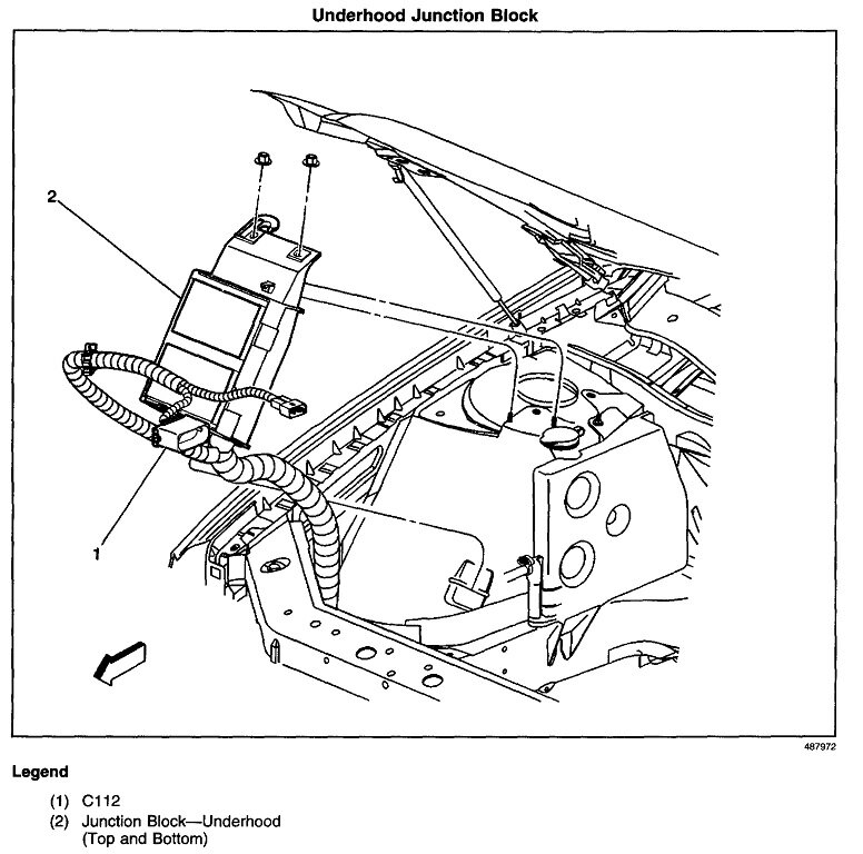

To help you get started with isolating different parts of the circuits, I saw the two connectors I have the orange arrows pointing to. If you can find them and unplug them, that will remove those parts of the circuit. If the short is on either of those circuits, unplugging them will make the test bulb get dim or go out. The last two drawings show where those two plugs are located. The notations suggest you're going to have just one of them, depending on the options on the car.
See how far you get now, and let me know what you find.
