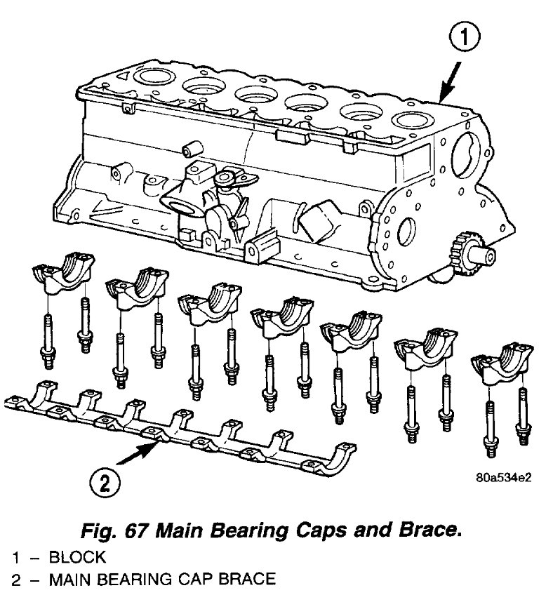

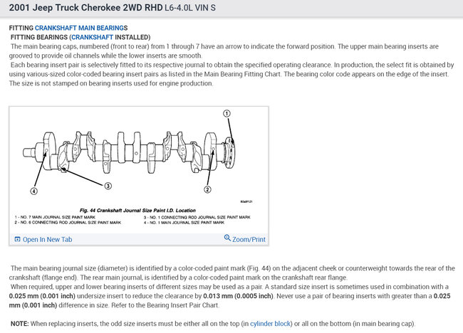

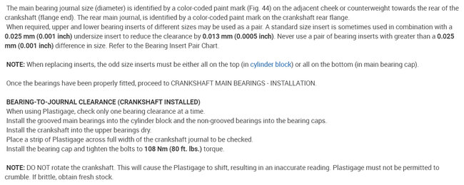

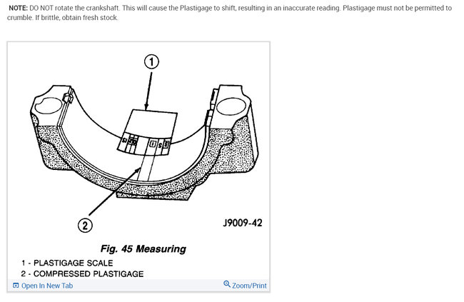

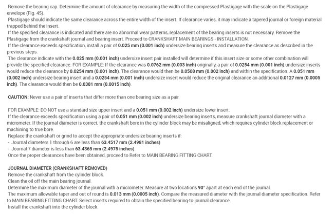

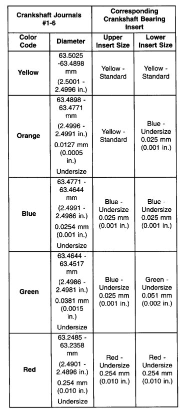

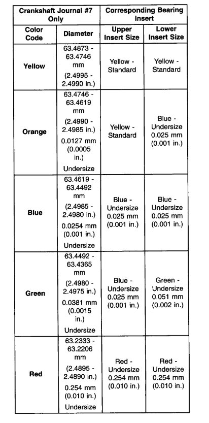

Here are the tolerances and torque specs for the crankshaft and rod bearing with fitting guides below.
1. Tighten the bolts of main bearing caps # 1, 2, 4, 5, 6 and 7 in three steps.
- Step 1: 54 Nm (40 ft. lbs.)
- Step 2: 95 Nm (70 ft. lbs.)
- Step 3: 108 Nm (80 ft. lbs.)
2. Push the crankshaft forward and backward. Load the crankshaft front or rear and tighten main bearing cap bolt # 3 in three steps.
3. Install main bearing cap brace and tighten nuts to 47 Nm (35 ft. lbs.).
Here is how you use a torque wrench:
https://youtu.be/juOClONIWeY
Check out the diagrams (below). Please let us know if you need anything else to get the problem fixed.

looking for the specs on the crankshaft so i know if i need to polish or grind them plus i need to know what bearings to buy .010 .020 .030
Nov 7, 2018 at 9:22 AM (Merged)
CRANKSHAFT End Play 0.0015 to 0.0065 in
Main Bearing Journal Diameter No. 1-6 2.4996 to 2.5001 in
No. 7 2.4980 to 2.4995 in
Main Bearing Journal Width No. 1 1.086 to 1.098 inch
No. 3 1.271 to 1.273 inch
No. 2-4-5-6-7 1.182 to 1.188 inch
Main Bearing Clearance 0.001 to 0.0025 in
Preferred 0.002 in
Connecting Rod Journal Diameter 2.0934 to 2.0955 in
Connecting Rod Journal Width 1.070 to 1.076 inch
Out-of-Round (MAX) 0.0005 in
Taper (MAX) 0.0005 in
Main Bearting Cap - Bolt 80 ft.lb
