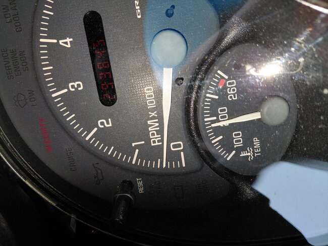

Thanks Ken for replying back to me. I have replaced vacuum lines and replaced all the sensors on my throttle body an I still have the same idol problem wish I can get it running right. I called a couple shops but they want to run i diagnostic test on it but can't afford it I been working on my own for for years. I have a picture for you hope you can still help me out with the problem. Thanks again

I need a video of the engine idling, did you run the codes?

This is the car running but it only does it when it's all warmed up the idol is low. I do have alot of blow by an when I take the oil cap off I have air coming out so I may think it could be rings an seal issue but don't know. I have tried everything replaced just about everything sense in the car fixed all the vacuum lines everything so don't know what it could be.
