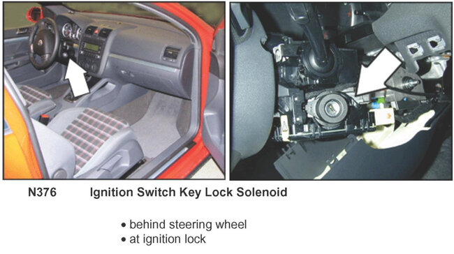

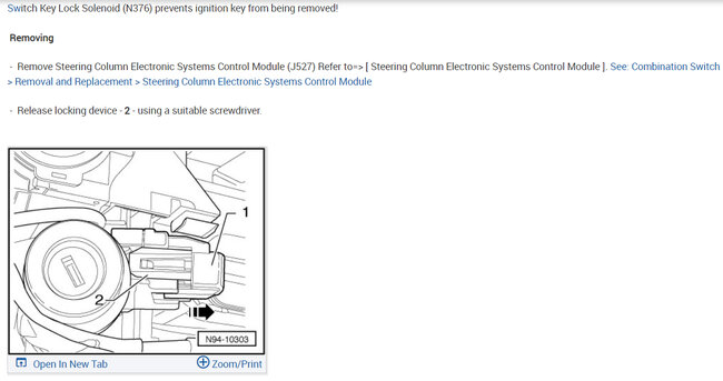

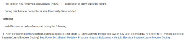

Yep, these tumblers fall apart internally and when they do it's time for a new unit. Here is how to replace the ignition tumbler lock. You can find a new one on Amazon. Here is one for $29.00:
https://amzn.to/3WZRTXS
This guide may help as well:
https://www.2carpros.com/articles/ignition-switch-wont-turn-stuck
Steering Column Switch
Steering Lock Housing
CAUTION!
When disconnecting and connecting battery, the procedure must be followed as described in the repair information. Refer to=> [ Battery, Disconnecting and Connecting ] See: Battery > Procedures > Battery, Disconnecting and Connecting.
To remove steering lock housing, it is first necessary to remove base carrier for steering column switches.
CAUTION!
Steering lock may be destroyed.
If steering lock is operated without lock cylinder, it locks and must be replaced.
Steering lock must not be operated without lock cylinder.
