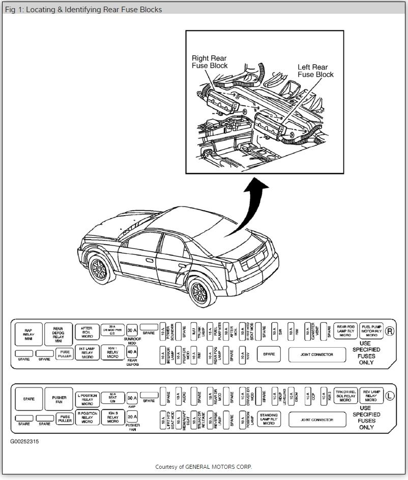

Where is the ignition switch relay on the 2003 Cadillac CTS?
Mar 14, 2016 at 2:52 PM
HMAC300
  • 48,601 POSTS
it's in the under hood fuse block. It should have a diagram on underside cover of fuse block.
Mar 14, 2016 at 4:04 PM
Hi here is a diagram of your PDC
Please let us know what you find

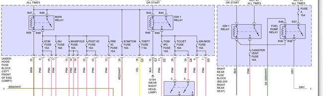

Security test done 30 minute learned done starter, starter relay checked switch, checked no start, no crank, but security light goes out. I notice the switch is hot which leads to a negative ground or broken wire.
Mar 16, 2016 at 12:29 PM
HMAC300
  • 48,601 POSTS
it might be a bad switch too as they go bad.what I'm sending is what we have which is part of engine performance yellow wire is crank and pink is to coils. It could also be a bad connection in fuse box under the hood.
