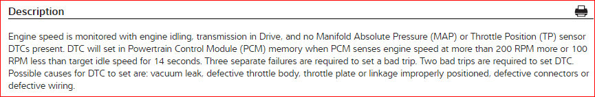

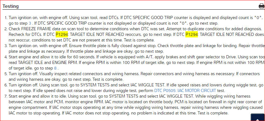

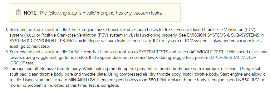

Hello, I am Danny,
I have attached a series of pictures for testing your Idle issues. I would have your mechanic check for MAP (Manifold Absolute Pressure) or TPS (Throttle Position Sensor) problems. Hope this helps and thanks for using 2CarPros.

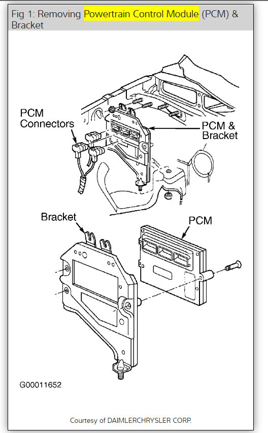

It sounds like you have a bad PCM. I would try a used/rebuilt unit to see what happens here is the location below.
Here is a guide that can help as well:

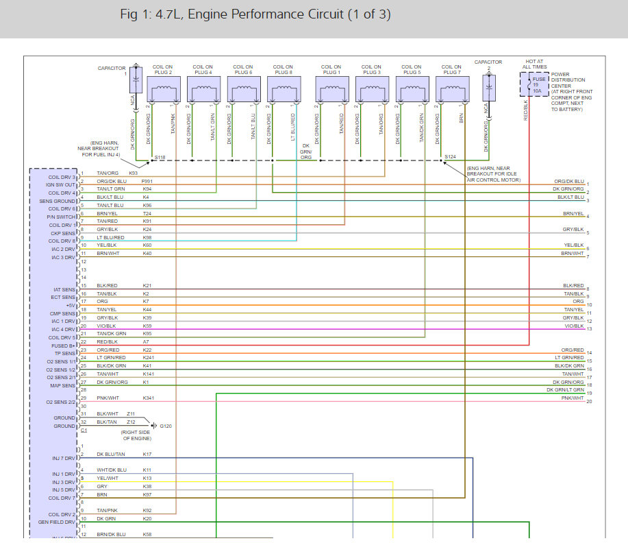

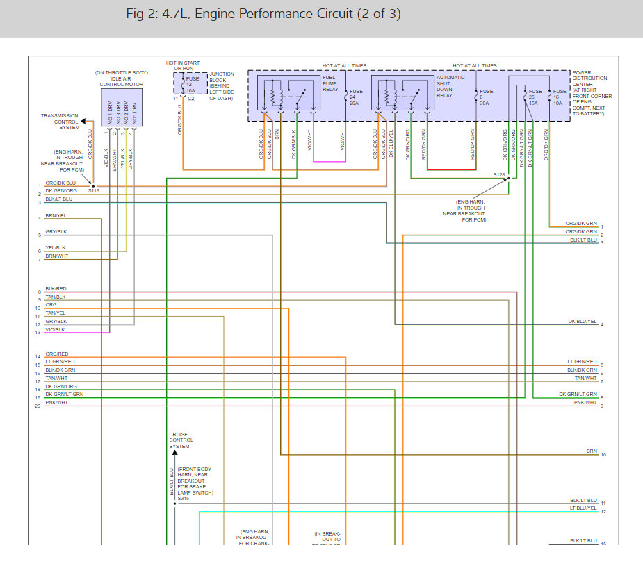

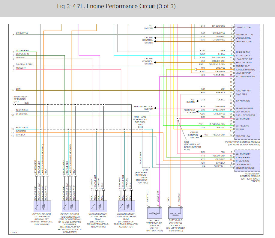

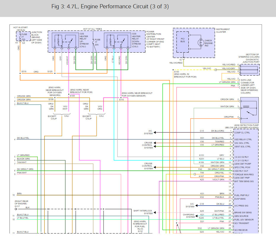

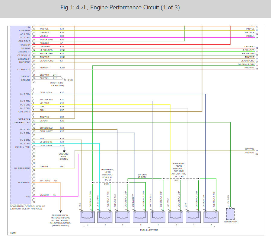

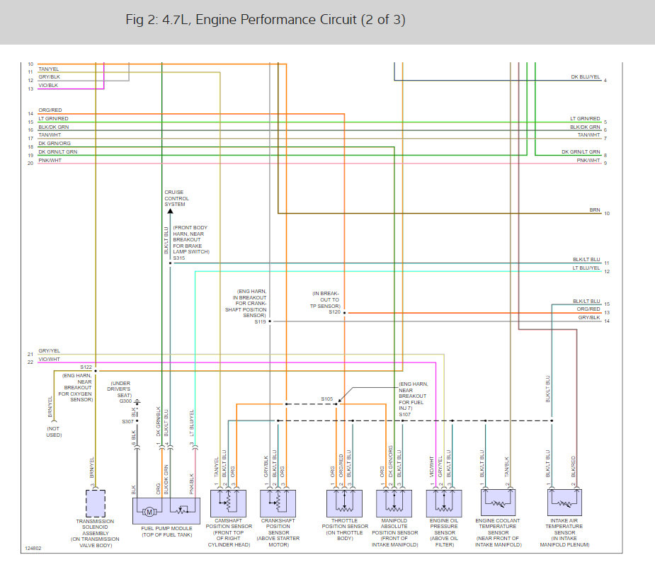

Sorry, missed that in the first post. Can you remove the vacuum line to the power brake booster and plug it to see if that makes a difference please? If that does not work lets do a pin to pin test to check for high resistance wires in the throttle control circuits. Here is a guide and the engine wiring diagrams so you can get started:
Check out the diagrams (below). Please run some tests and get back to us.

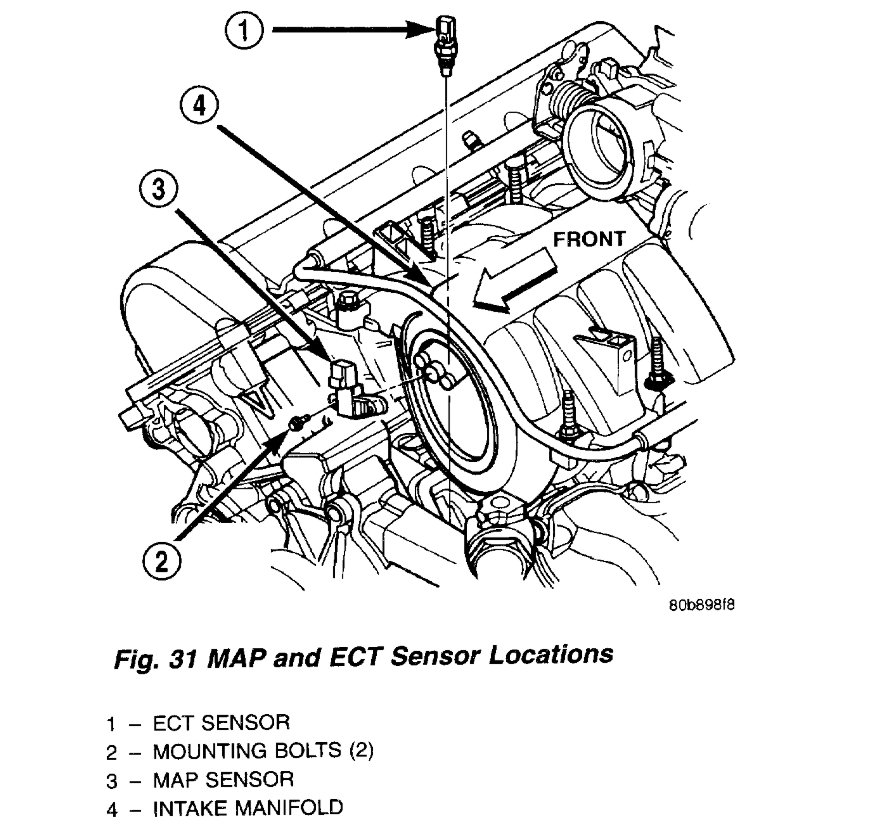

A MAP sensor could definitely cause the issue. Here is its location so you can replace it.
