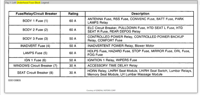

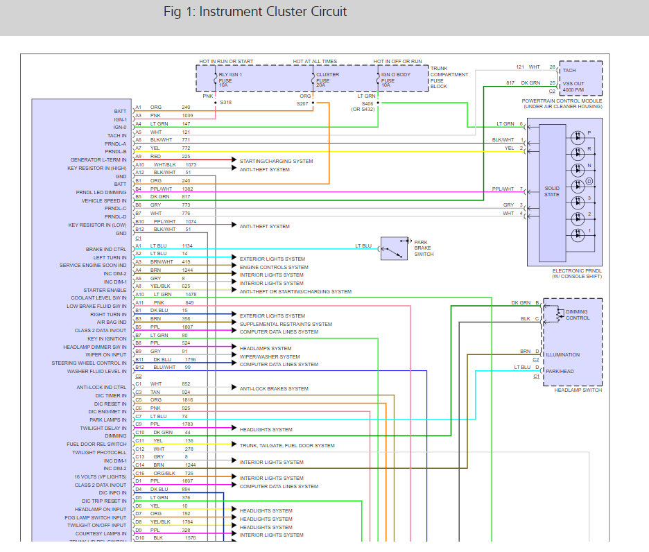

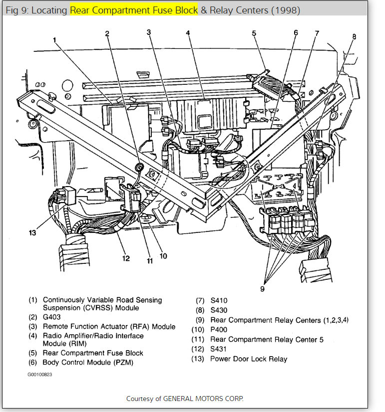

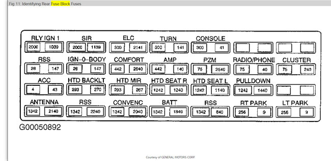

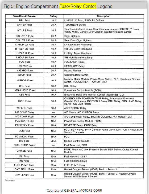

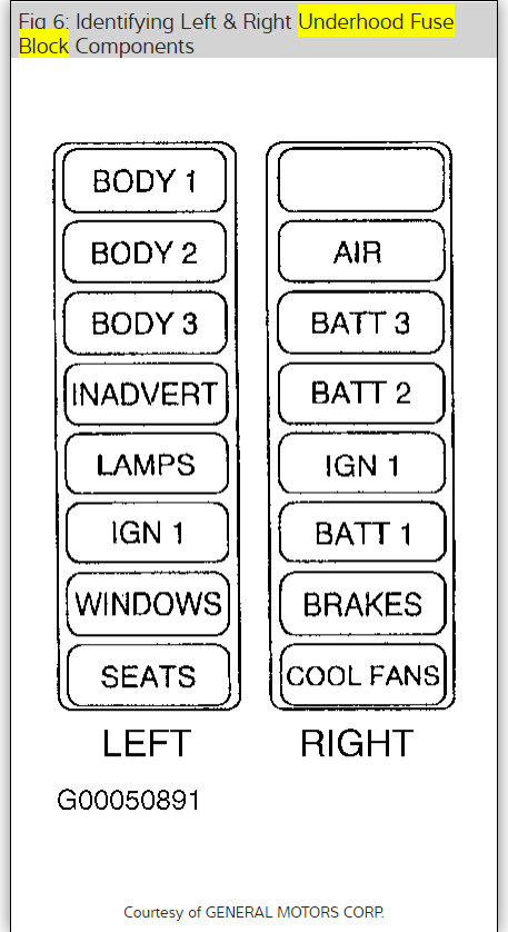

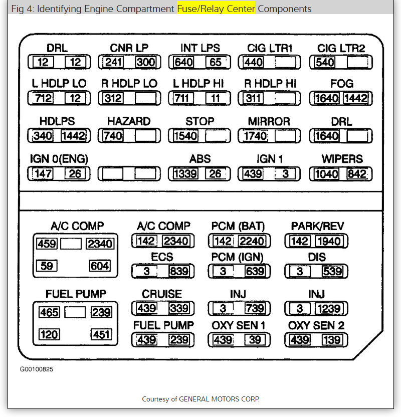

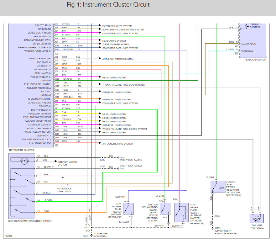

It sounds like a fuse is out or the cluster has gone bad. Let's check the fuses (Ign, cluster and body 0) and wiring first.
Here are the cluster wiring diagrams so you ca see how it works. Check out the diagrams (below). Please let us know what you find.
