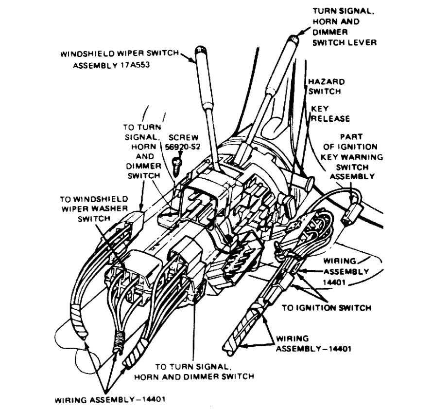

need to get to the ignition I have the plastic off the steering column but need to take off the lower panel to get that bottom piece off.
Jun 6, 2022 at 10:47 AM

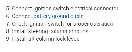

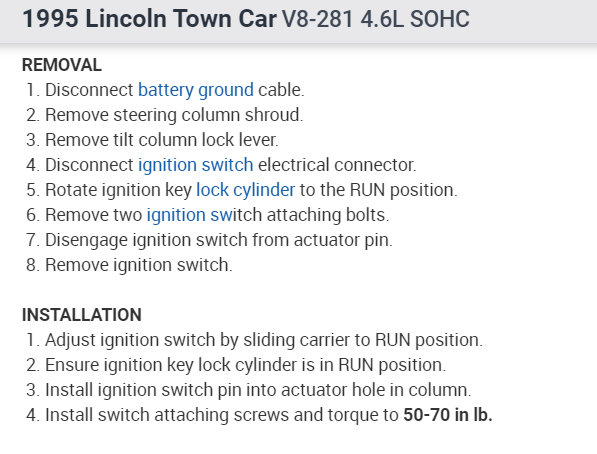

Directly under the panel there are two or three screws, this will help you remove the panel; the top is held on by clips. Gently pull off the panel, here are instructions on how to change the switch out. Check out the diagrams (below). Let us know what happens and please upload pictures or videos of the problem.
