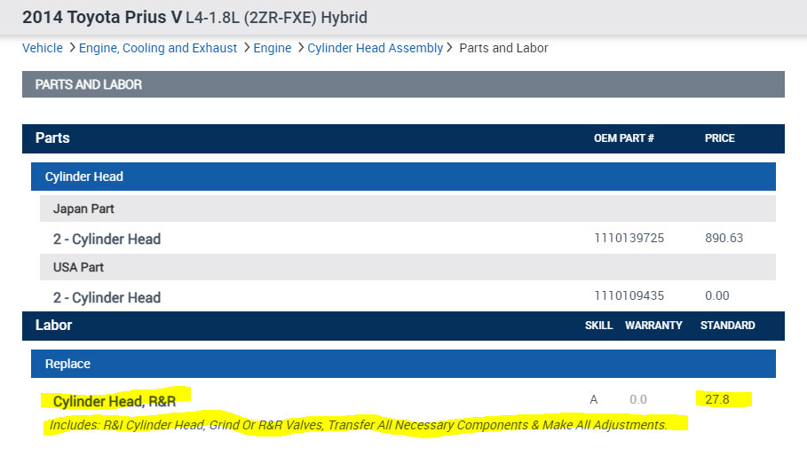

Toyota is saying that I need to replace my engine or buy another car. To have them verify/troubleshoot the problem it will cost me $2,125.00... Repairing is an additional cost. They said it's not a head gasket but likely a cracked head or block. My question is, is there's a way to distinguish a bad head gasket from a cracked cylinder head or block? Please, have you any suggestions. Thank you
This is what the Toyota mechanic sent to me:
Found code set p0301 and p0302 engine misfire /did notice low coolant in reservoir. Perform a block test at this time it failed, at this time exhaust gas going into the cooling system. need to tear down for inspection /option install a used engine.
$2,125.55 +Tax (Troubleshoot cost only)
Used Engine 98,000 Miles - 1y P/L Warranty. Engine Replacement.
$12,389.77 + tax
