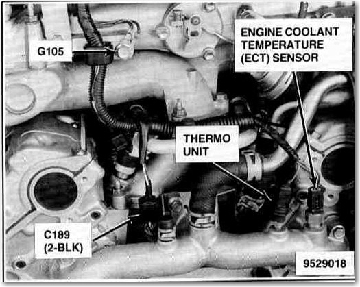

Where is the coolant temp. sensor located on this 96 isuzu rodeo 3.2 ? I've checked a haynes repair manual, and it mentions the temp. sending unit, but not the sensor. These are two different things, right.

I founds this diagram for you (below) and a guide to help walk you through the steps, please let us know if you need anything else.

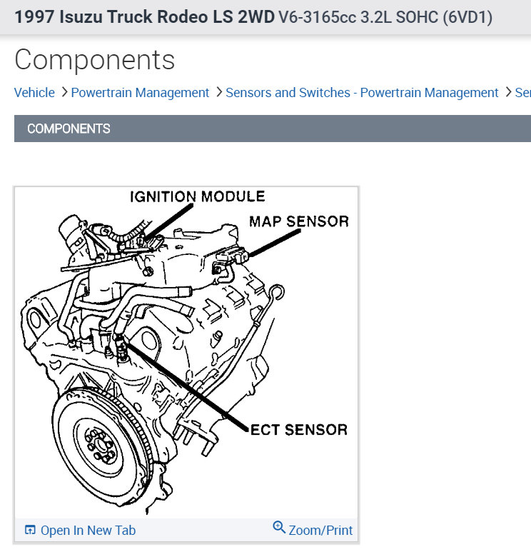

Hello, the coolant temperature sensor is located at the rear of the engine on the coolant crossover pipe near the firewall.
I have attached a picture for you, hope this helps. Lou

first ensure you installed thermostat correctly , if so then check the sending unit, it is at the rear of the engine in the engine coolant manifold on the 3.2L engine

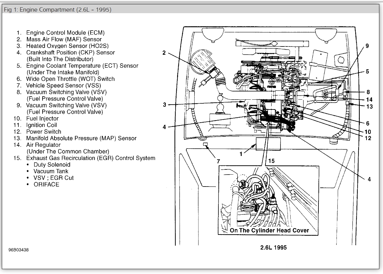

JMRSSMITTY
Engine Cooling problem
1994 Isuzu Rodeo Question 6 cyl Two Wheel Drive Automatic
where is the coolant temperature sensor located?
