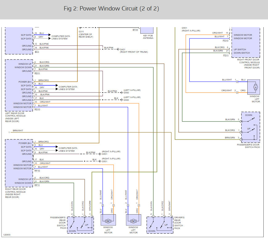

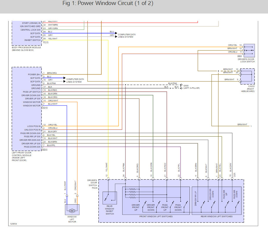

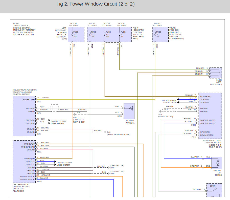

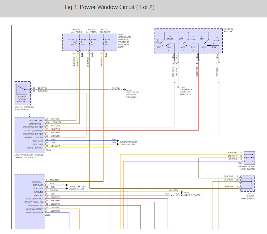

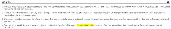

Here are wiring diagrams so will more know what I'm talking about. The unknown switch on the driver's switch pack is a lockout for the rear windows. The first thing we need to check is power to the driver's window motor.
Check out the diagrams (Below). Please let us know what happens.
Cheers

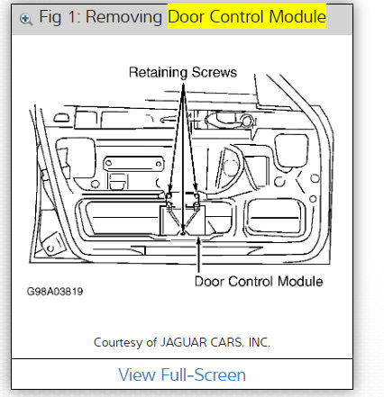

Yes the drivers door module is bad and needs to be replaced. When doing so it will need to be programmed to the car. It should cost about $130.00 for the programming. You can try a used unit as well it might plug and play.
