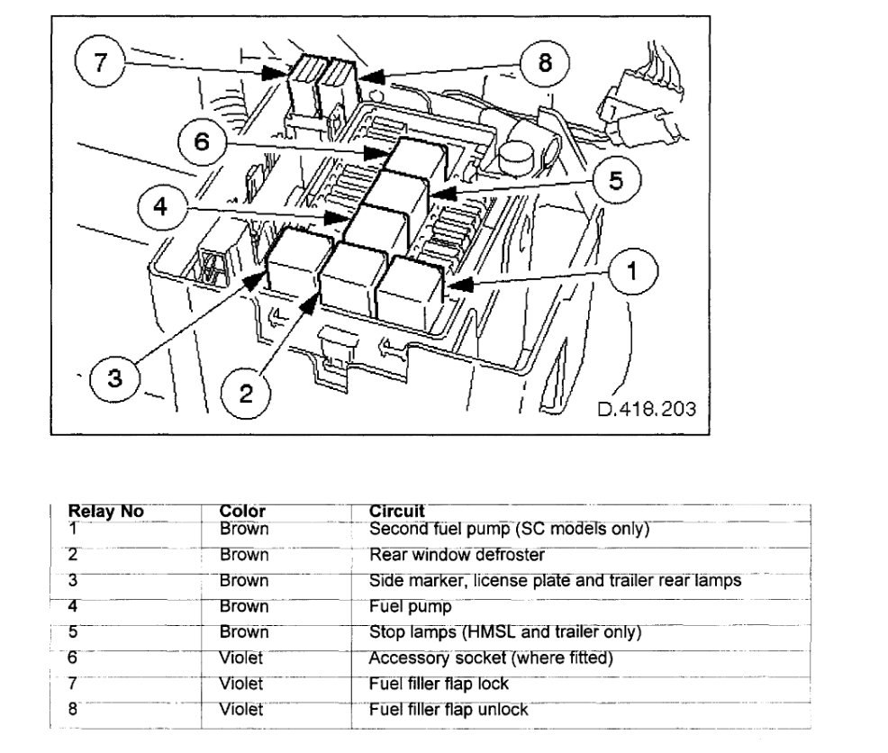

where is the fuel pump relay located?

Here is a guide to help you test the relay and the location of the relay in the diagrams below.
Check out the diagrams (Below). Please let us know what happens.
