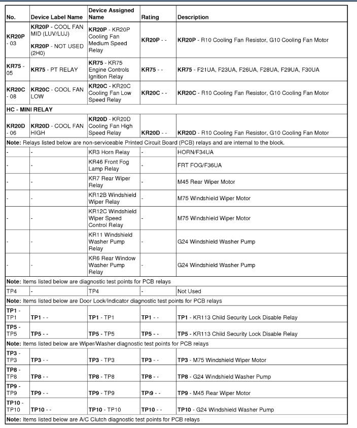

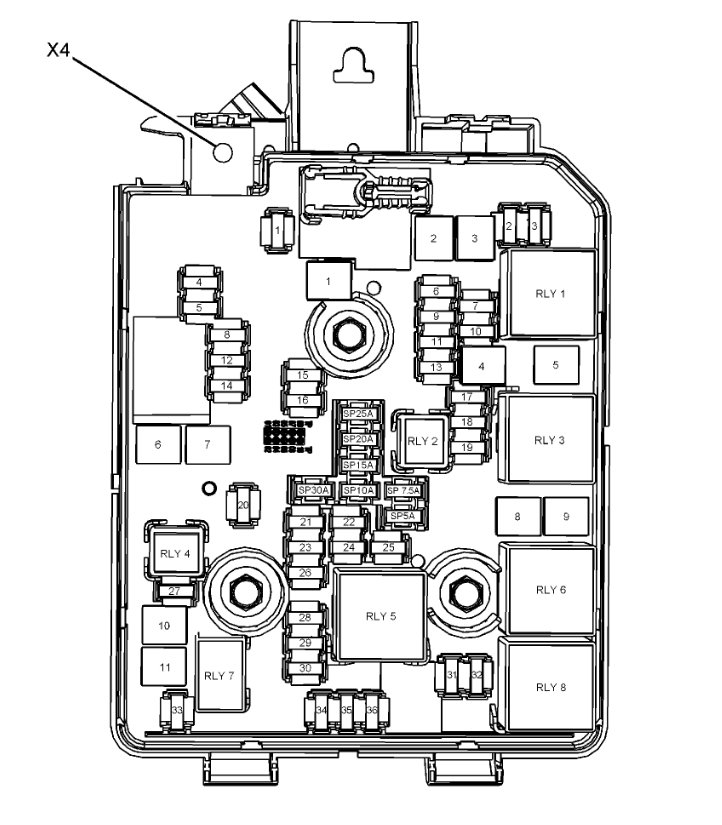

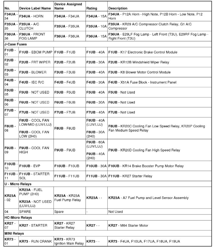

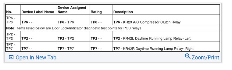

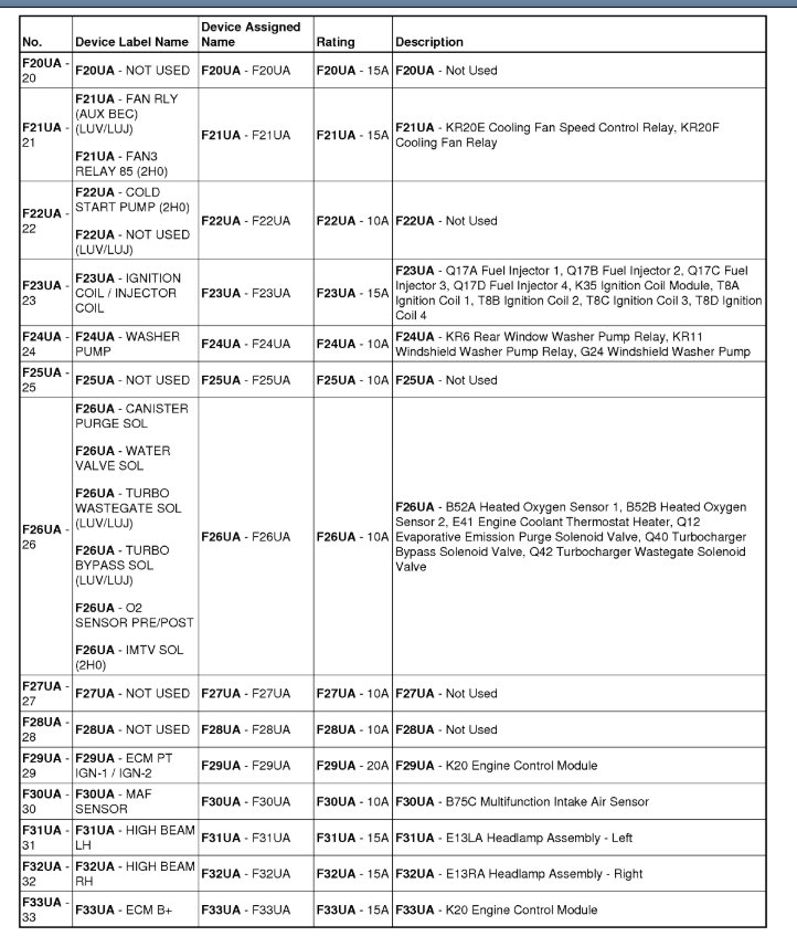

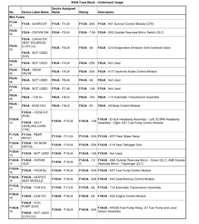

Okay, lets clear the codes, then with the codes cleared turn the key on without cranking the engine to see if any codes come up this will be the one we chase it should if the others. If no codes come up crank the engine then read the codes again. Can we check fuse #18 for power (key on) here is a guide to help and the fuse location in the diagrams below.
