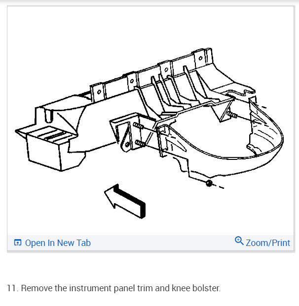

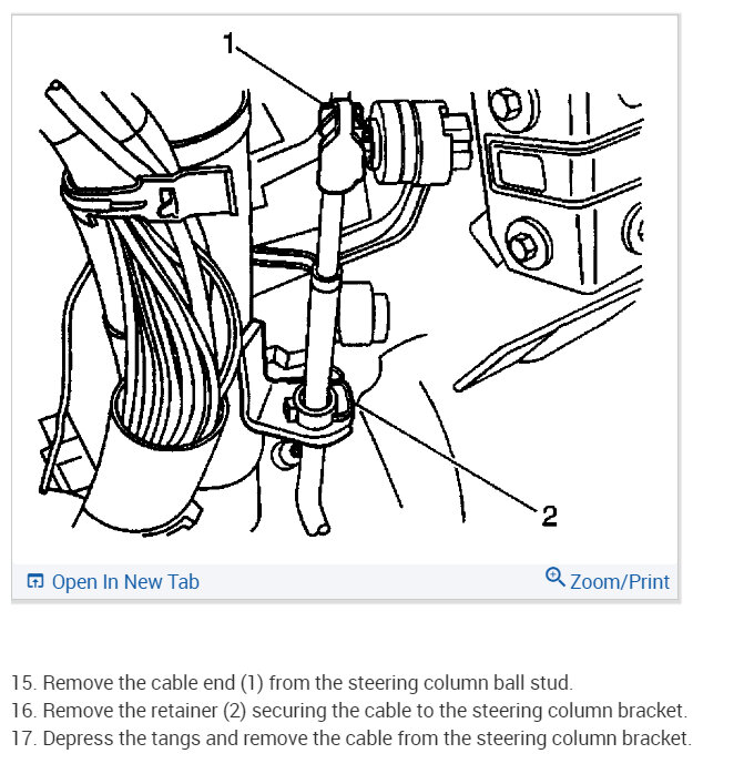

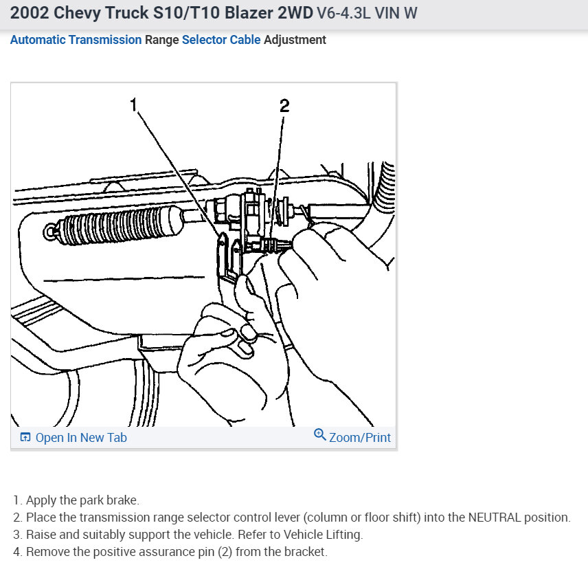

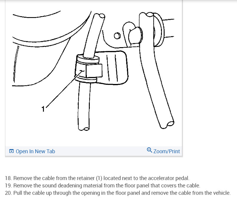

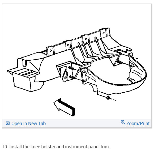

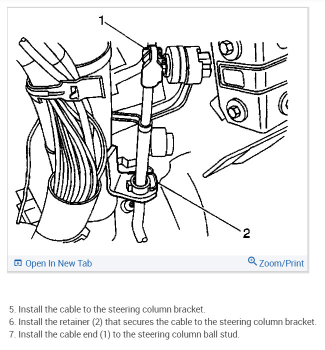

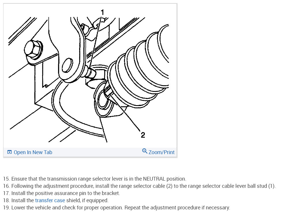

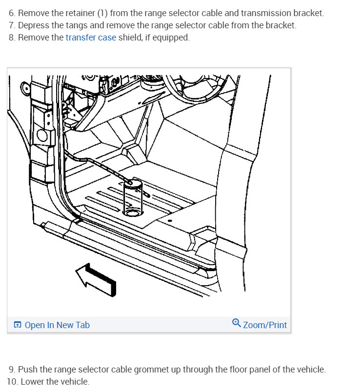

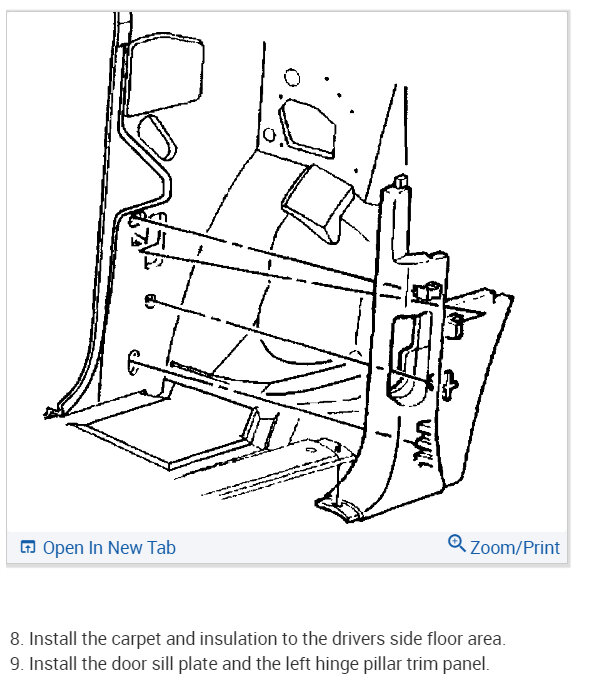

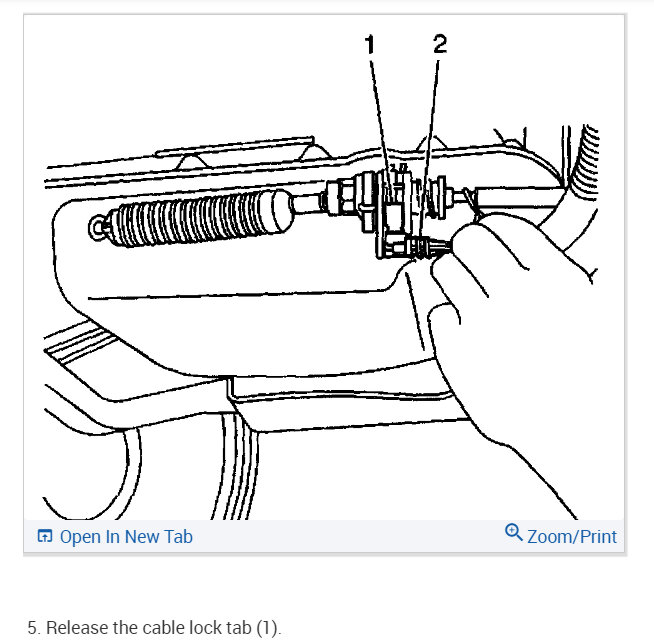

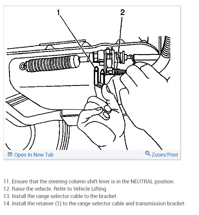

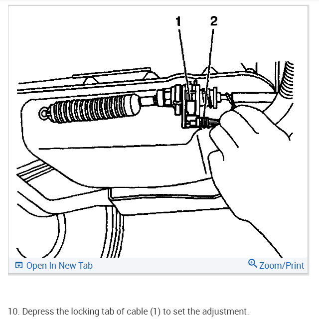

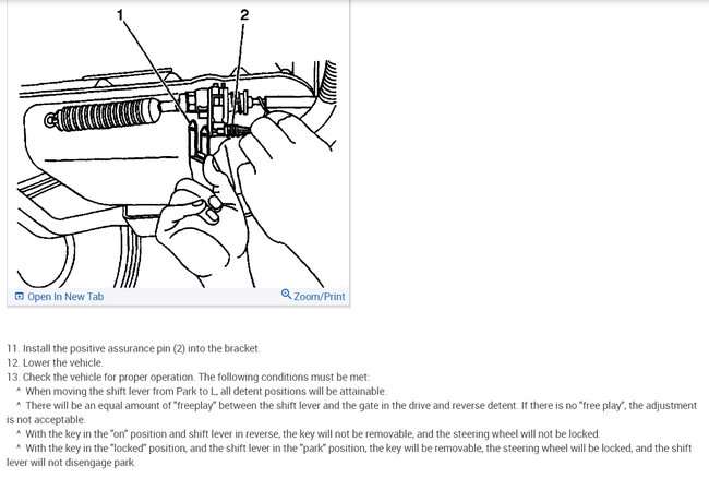

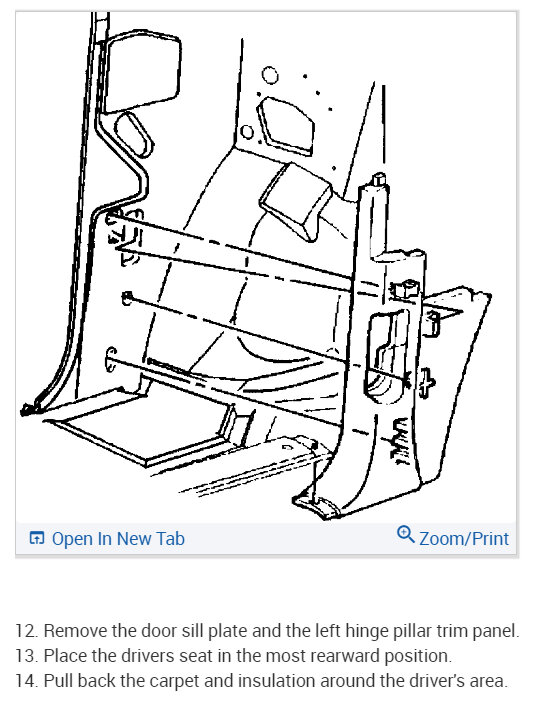

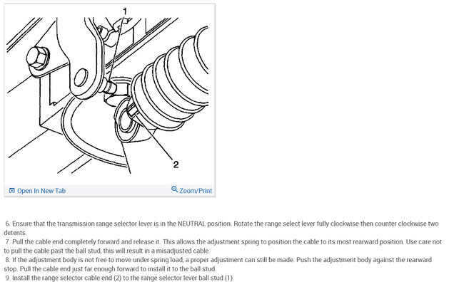

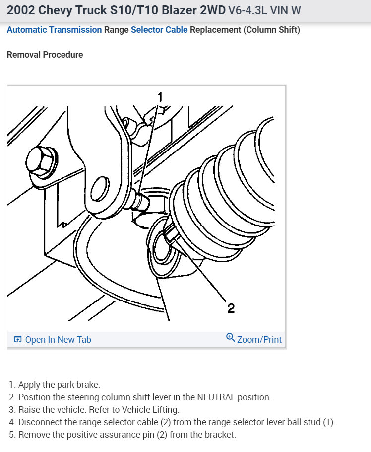

Yes, if the shifter cable is stretched or out of adjustment the key will not come out of the ignition. here is how to replace/adjust the shift able to help fix the problem. Check out the images (below). Please let us know what happens.
