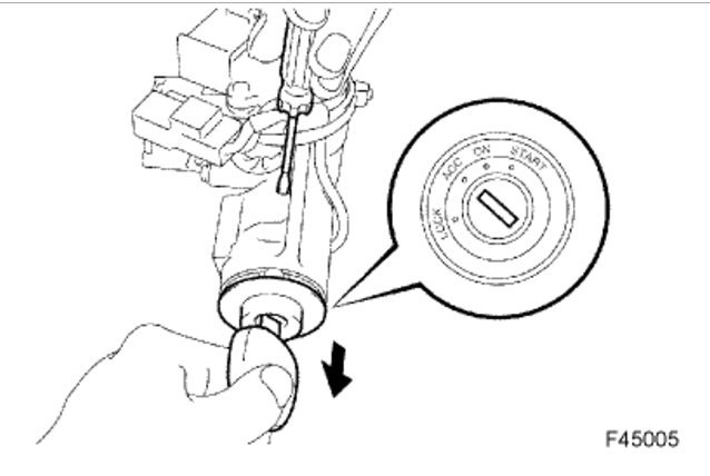

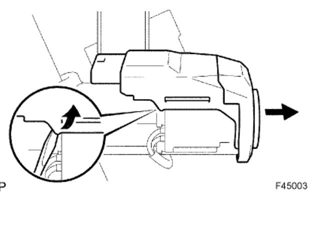

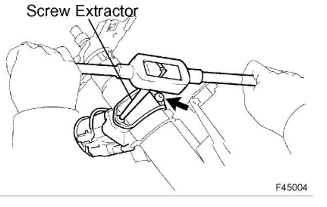

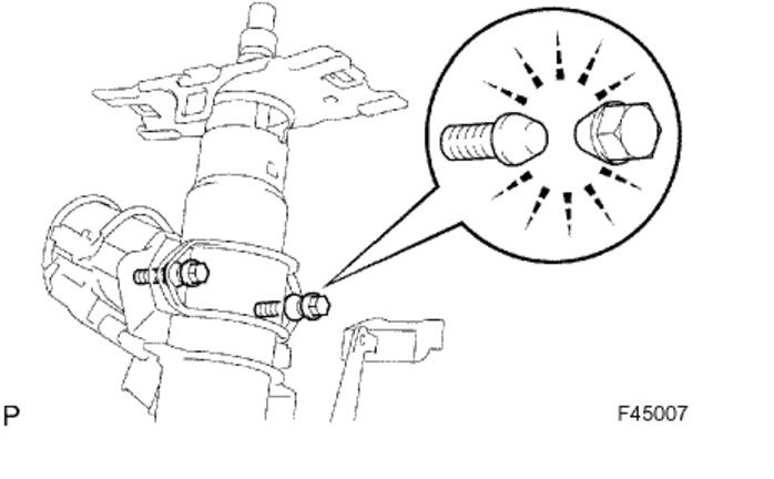

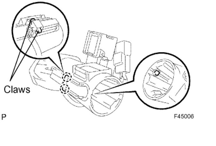

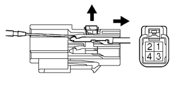

Here are some guides if you want to replace the ignition switch
