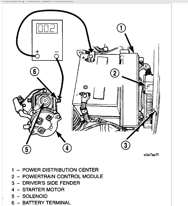

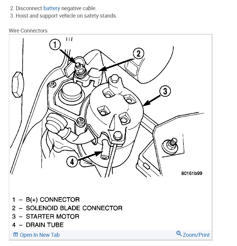

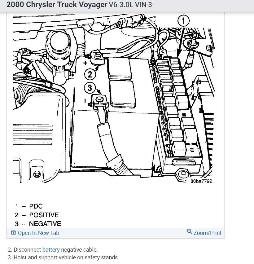

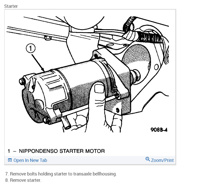

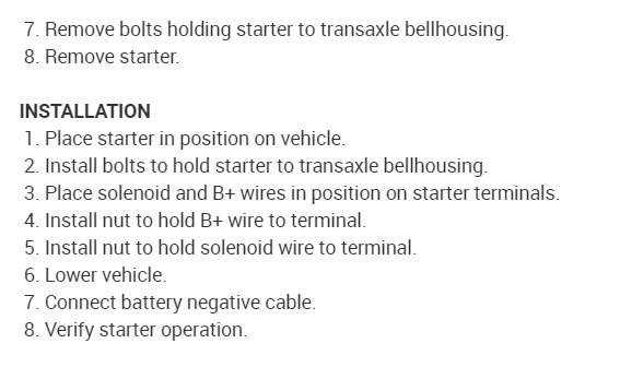

So, is this hard to start the engine or hard to get the engine to crank over, can you upload a quick video of what is going on? It sounds like the engine will not crank over, which 9 times out of 10 will be the starter motor. Here is a guide to help and the starter location and replacement instructions in the guides below:
https://www.2carpros.com/articles/starter-not-working-repair
