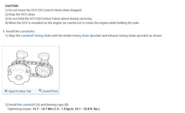

it does have a timing chain in back of head connecting the 2 cams
Sep 16, 2022 at 4:54 PM
Here are the marks for the rear of the camshaft chain. Not the cam lobes.
