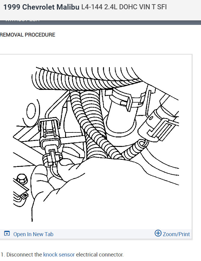

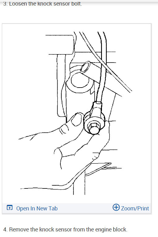

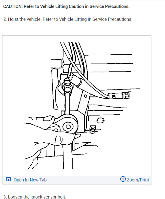

Needed a diagram or a specific location for the knock sensor.
Oct 8, 2024 at 11:34 AM
CERTIFIED EXPERT
53,855 POSTS
the knock sensor is on the top left side of the engine. Check out the images (below). Let us know if you need anything else.
