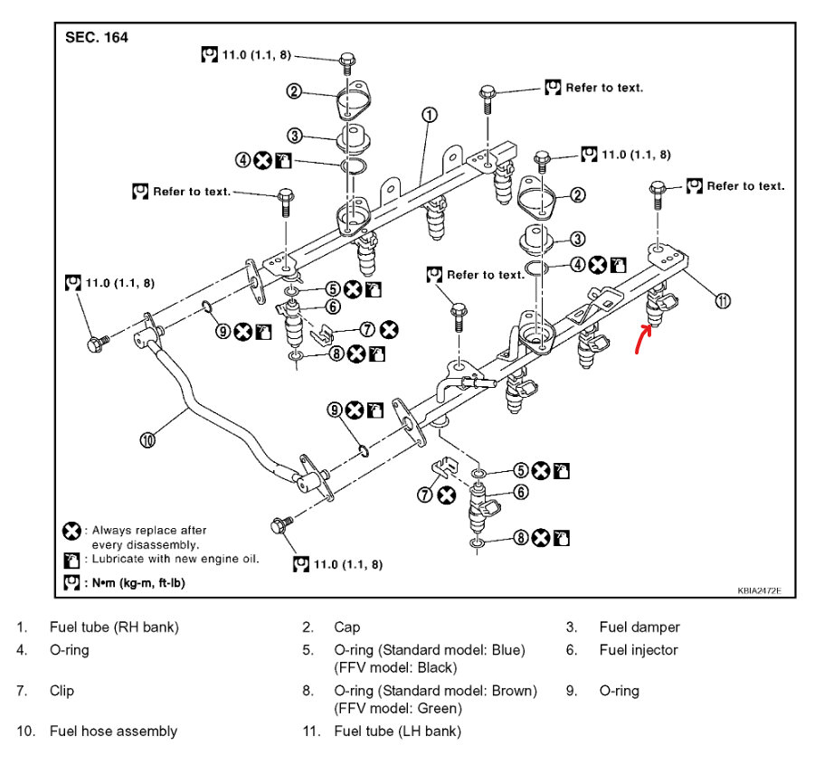

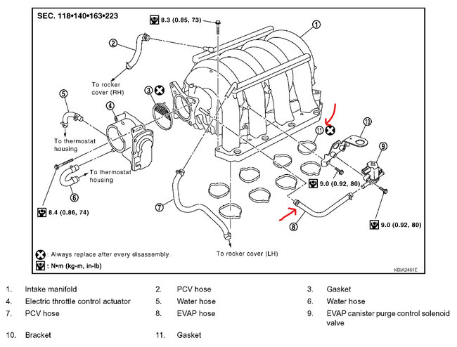

It could be the intake gaskets, a vacuum line or the fuel injector O rings have let go, you may be able to figure it out better by going over this guide:
I have included the typical leak areas in the images below. Please upload pictures or videos in your response of any problems so we can see what to help you with.
